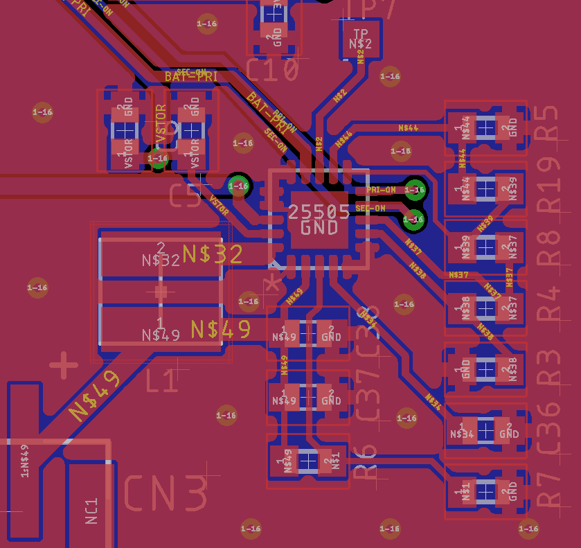

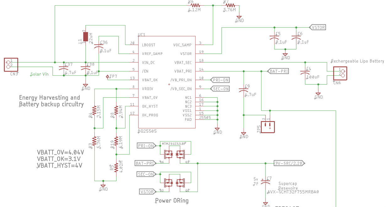

We are implementing the BQ25505 and it seems to be working pretty well except for the fact it seems to be drawing more current than what the circuit actually calls for.
We can power the circuit without the BQ25505 we will draw only around 10uA.  But with the BQ25505 inline it seems to consume about 2mA for whatever reason.
Hope you can give me some ideas here.  Attached is the schematic and pcb.
Thanks for your help

    • vbat_Pri is usually set to 3.6V
    • and Vin_dc is generally set to 5V set at 300mA maximum
    • a 3.7V / 850mAh lipo sits at vbat_sec
    we programmed our chip to have:
    • vbatt_ov=4.0V
    • vbatt_ok=3.1v
    • vbatt_hyst=4v
    the battery is charging right now.  Vbatt_ok test point is not active.

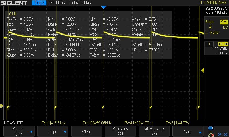

    the following is a screen capture of the lboost pin
  • Henrique,
    Your input voltage (VIN_DC) is greater than your VBAT_OV threshold. This charger is designed to act as a boost charger. In a boost charger, the input voltage is less than the battery voltage. In BQ25505 whenever this occurs the first NFET in the functional block diagrams turns on and current flows as I have shown to ground. This seems like the most likely source of your leakage current. To prevent this, I suggest lowering your input voltage or clamping it appropriately for your design.
