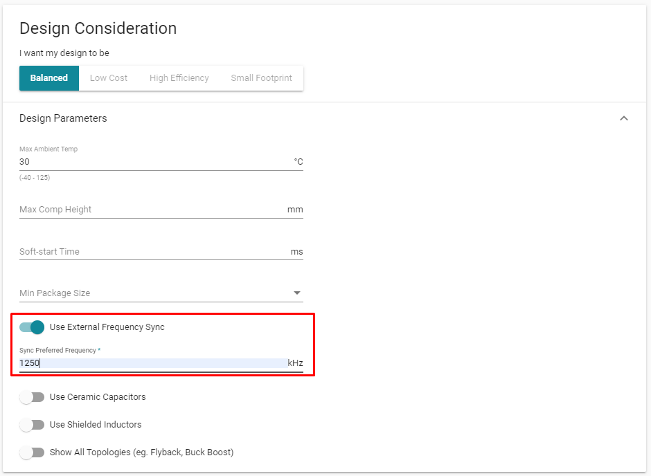

  • Hi Efi,
    It may be more efficient to discuss through email. Can you please email me at kristoffer.flores _at_ ti.com?
    I am putting some of my questions and comments here and we can continue the discussion in email.
    There are many rails here, and I want to make sure I understand which outputs you need to be derived from which intermediate/bus voltages etc. For example, is the 5V you mentioned above a separate source from the 10V input from your first post, or the 5V is derived from the 10V (and is it the same as the 5.25V you first mentioned, and the 19A is the total input referred current you expect)?
    I am compiling a block diagram based on my understanding and we can work together on filling that up with power recommendations for each rail.
    What FPGA are you using? Perhaps we already have a reference design showing a power solution for it.
    In addition to looking for a reference design for your FPGA, we can use WEBENCH Power Designer as a starting point to see the potential solutions for each input to output voltage/current requirement. In the tool, you can specify the requirement for an external synchronization frequency and the solutions presented will be devices that can support that synchronization frequency based on the tool's efficiency, thermal, and other (timing, current limit) calculations.
