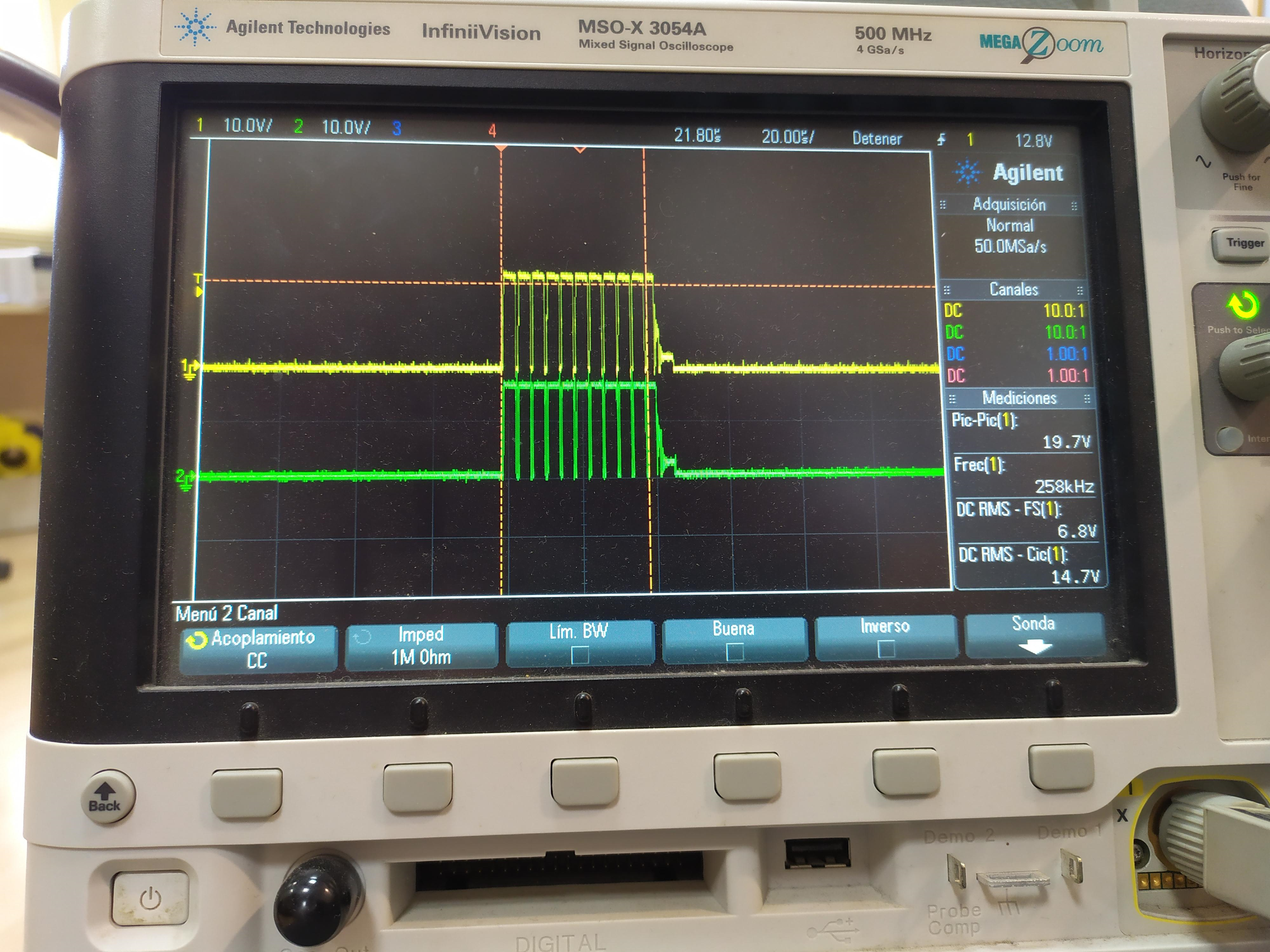

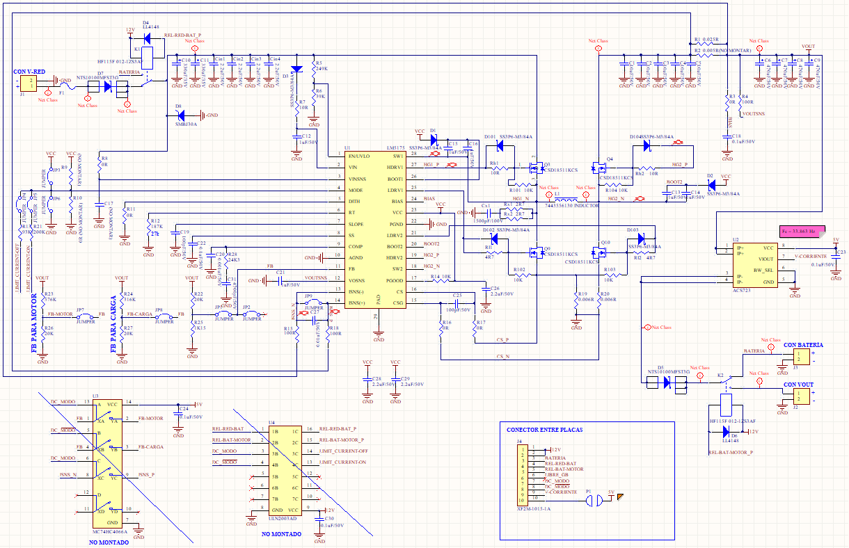

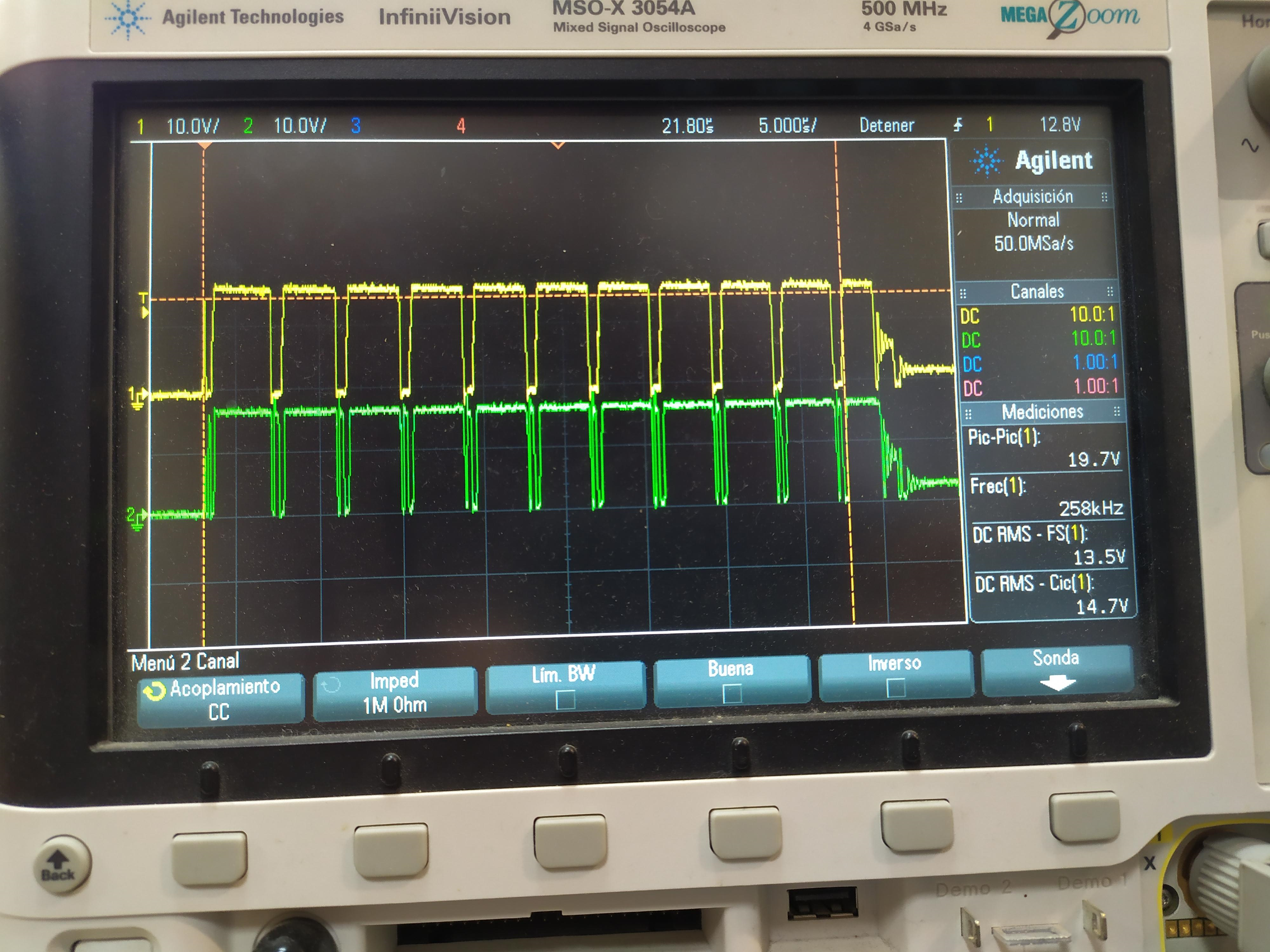

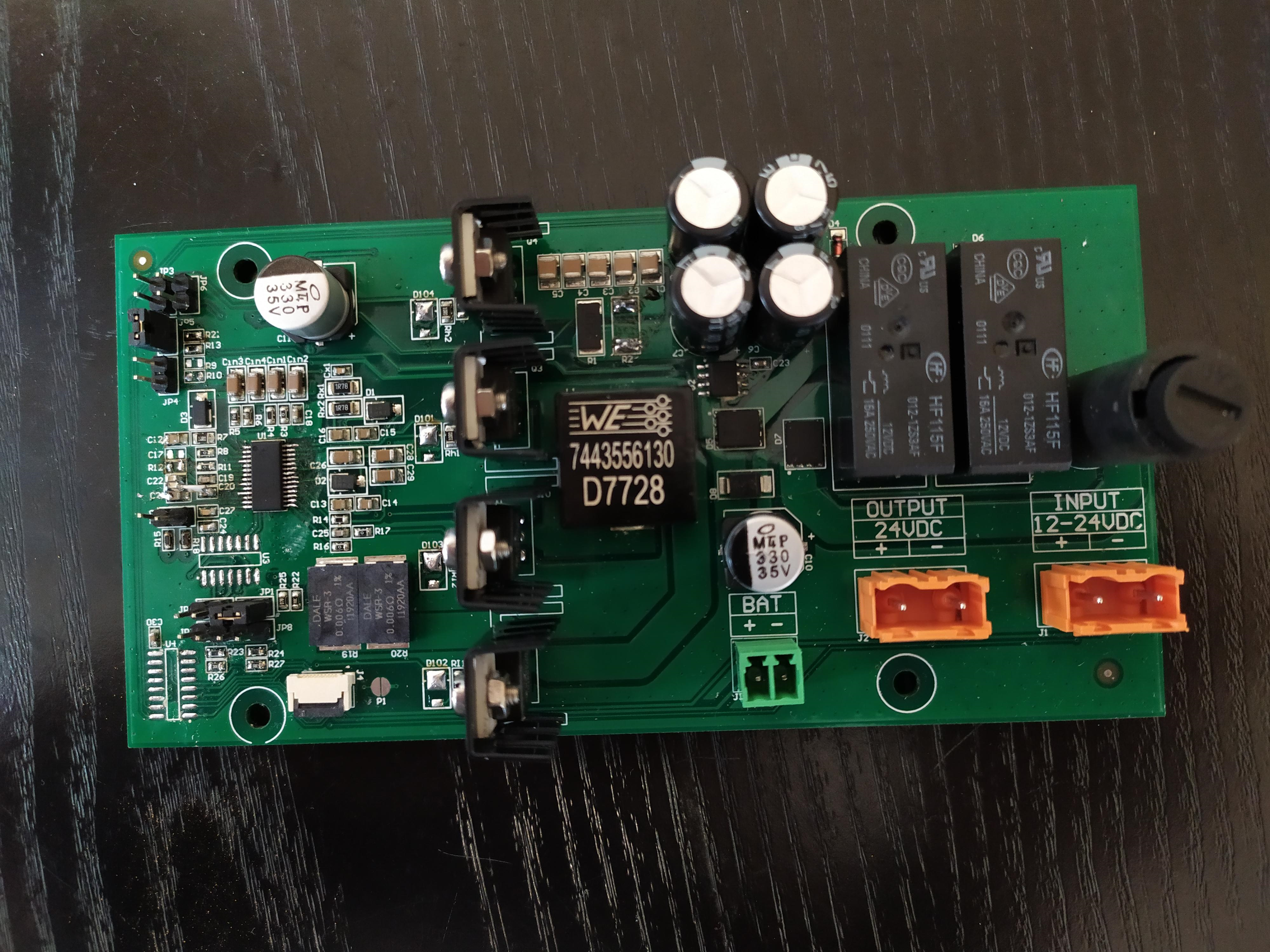

  • Good morning, thanks for answering.
    I enclose the circuit diagram, the measured signal of SW1 (yellow color) and SW2 (green color) and a photo of the PCB.
    Current situation of the circuit for the tests performed:
       1.- I have changed the LM5175 to the LM5176 and changed the RT resistance to 30K. These images that I have attached are with the LM5176.
       2.- I have put the MODE pin to GND with a 200K resistor.
       3.- The U3 and U4 ICs that appear in my schematic have been removed to ensure that they do not cause problems.
       4.- Jumper JP1 inserted.
       5.- Vin = 17V
       6.- Vout = 14.3V
       7.- If I load the IC LM5176 increases the frequency of audible sound noise.
       8.- If I increase Vin> 17V and do not put any load, I will regulate the Vout = 14.7V, if I decrease Vin <17V Vout it will decrease.

  • Thank you for the info.
    From your schematic, you used 0 Ohm at R16 and R17.  Can you use 100 Ohm each and change C23 to 1nF, 2.2nF, upto 4.7nF and see if there is any improvement?
    From the layout, I found you did not follow our datasheet layout guideline, nor referring to the EVM layout pattern.  Both buck and boost switching legs use the current sense resistor.  So, the layout should be symmetrical.  Also, you ac current paths form a large loop, introducing inductance, and hence causing noise. Please refer to our EVM example to place and route connections between the MOSFETs, input and out capacitors, current sense resistors.  Also pay attentionto the current sense Kelvin sensing and gate drive traces.  The gate drive and return traces should be closely side by side.
