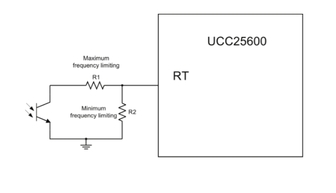

in UCC25600, frequency can be adjusted by below circuit, does LM5036 support this circuit to adjust frequency?

    The principle of oscillator of LM5036 and UCC25600 are the same.
    From the simulation, the frequency of LM5036 can be regulated by changing the current flowing out of RT pin.
    So I think that LM5036 does also support this circuit to adjust frequency.
