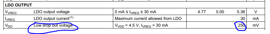

My customer is using TPS53319 on a number of our boards, and is starting to see issues.
Vin is 5V with a 1V output..
TPS53319 has an LDO internal but I can’t see the LDO working reliably with 5V input when it wants to output 5V? The datasheet talks about 4.5V input minimum. In that case I really struggle to see how an LDO would work.
I need to confirm if a 5V input to this part is a problem.
Any guidance would be appreciated.

         When the VDD is greater than 5V+Drop-out-voltage, the LDO will be able to regulate its output to 5V nominal. Using a drop of 250mV as per datasheet, if VDD is greater than 5.25V, then LDO output will be 5V. When the VDD voltage gets lower than that, then the LDO will operate in drop-out mode and its output will be VDD-Dropout voltage. So when VDD is 5V, then LDO output will be 4.75V. The internal circuitry will still operate with the LDO output, however the LDO output will be lower than 5V.
    You can look into the Eelectrical Characteristics table in the datasheet.
