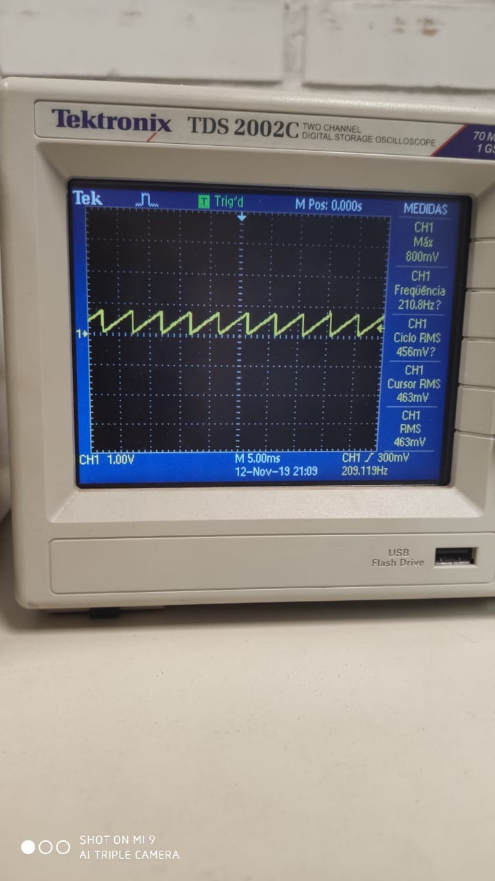

We set up the following circuit and when we went testing it didn't work. This circuit isn't working, the LEDs don't light. Could you help us figure out the problem? The Vref=5V, PWM=4,2V. In attached is the pin SS.

Please give scope capture of the following signals and trigger on SS with 1mS time base:
Scope capture 1: CH1: SS CH2: DIM/PWM CH3: IADJ CH4: GATE

The circuit is already working correctly, but the current on the LEDs should be 1A and is 0,5A. If we increase the iadj pin voltage above 0.6V(0,5A) the current starts to decrease. The maximum should be 2,1V for 1,2A.
