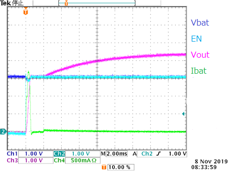

My customer is facing in-rush current problem.
She tried soft start application note below.
http://www.ti.com/jp/lit/pdf/slva553
However it was not effective before Vout=Vin timing.
In case of Vin=3V, Iin reaches Iswlim current before Vout=Vin.
This means no improvement.
Could you advise are there any method to reduce in rush current
smaller than 0.4 x Isw=1600mA?
Any advice should be highly appreciated.
