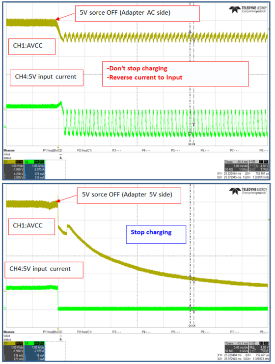

My customer have an issue about don't stopping device operation at disconnecting AC adapter input. Also it has the reverse current from battery to input.
Could you please support for the reason of this issue and improvement method?
When they disconnected the adapter AC side. this issue was occurred.
However, when they disconnected the adapter DC(5V) side. this issue was not occurred.(please refer the following waveforms)
This issue seem to depend on the output capacitance in the adapter.

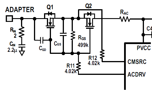

    Is there a 499kohm resistor (Rgs) from CMSRC to ACDRV as shown below?  If not, we have seen leakage cause the ACDRV charge pump to operate incorrectly when single cell batteries are used to power AVCC.
    Jeff

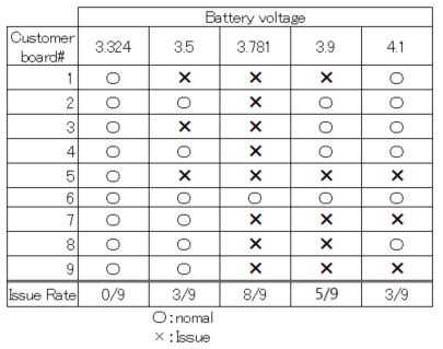

    Does this only happen at a certain battery voltage, for example, full charge?
    Is there a diode from BAT to AVCC?  If so, try removing it.
    If you lower the OVPSET resistors by a factor 10, does the additional loading on input stop the boost back?
    Jeff
  • Hi Jeff-san,
    Please refer the following table.
    There is not a diode.
    Customer tried to check by 1/10 OVPSET. However it is not solved..

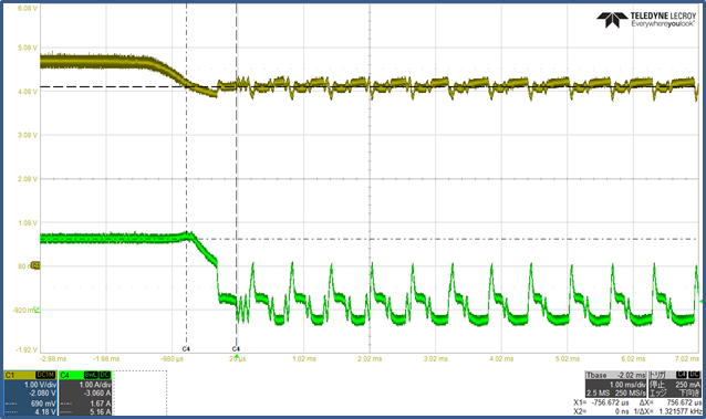

    Regarding the BTST capacitors, what is their voltage rating?  I want to confirm that DC bias derating is not a factor
    Can you add the switching node waveform to the present switching node waveforms for C(BTST)= 0.047uF and 0.1uF?
    How low of a resistance do you need to add from input side of FETs to ground to prevent the issue?
    Jeff
  • Hi Jeff-san,
      >> 50V
      >> Please refer the following waveform
      >> Customer try to add 12ohm resister. However the oscillation issue was still occurred. Please find the waveform at adding 12ohm below,

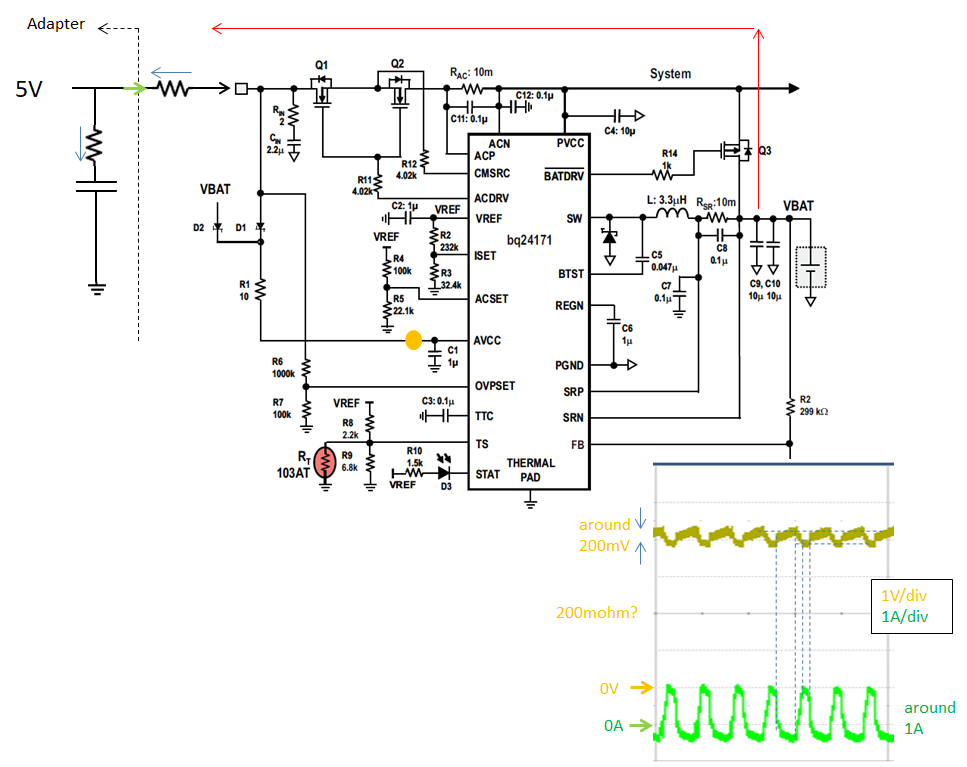

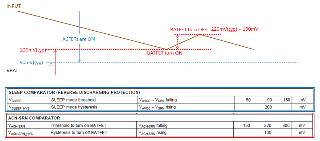

    My understanding is below,
    1. ACFET is ON at decreasing Vin voltage
    2. BATFET turn ON due to ACN<SRN+220mV(typ)
    3. Input current is stopped
    4. AVCC(&ACN) voltage will be increased due to input current change to 0A and Input resistance and capacitors in AC adapter resistance.
        Or Battery voltage is boost back to input cap
        Also, at this timing, it might have reverse current.
    5. BATFET turn OFF Due due to ACN>SRN+220mV(typ) + 100mV
       And, Charging start >> Input current will increase
    Repeat 2 to 5
    Is it correct?
    Customer checked this issue with our EVM and DC stabilized power supply for input voltage.
    Customer found the similar behavior at input voltage = Battery voltage + around 300mV.
    Could you please check it?
    Also, Customer is considering about adding reset IC for monitoring input voltage as below,
    Does it have any problem?
    Muk
  • Hi Muk,
    Essentially I think you are correct.  The input FET turn off time is to late/slow relative to the converter refresh pulse.  Also the adapter output capacitor holds up the input voltage just long enough to create a FB loop.  The reset IC might help but I would set it to a higher voltage, for a 12-V adapter, like 9V or to a % of input voltage if 5V adapter used.  Alternatively, if we can remove components or add a simple Schottky diode to speed up the Q1/Q2 turn off, that should work too.  Although not shown in the schematics above, is your customer using CDQ and CGS has shown in the graphic below:
    These caps are used to slow down turn on speed to reduce inrush current but also slow down turn off.  If replaced with lower value or removed completely, does that help?  If they add a Schottky across R11, cathode at ACDRV, does that help?

    Customer tried to remove CDQ and CGS. >> Not improved
    Customer tried to add a Schottky across R11, cathode at ACDRV. >> Not improved

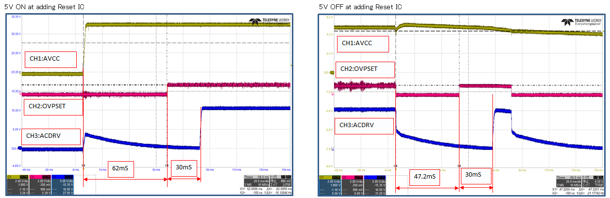

    Customer is considering to adjust the resisters for OVPSET for 9V or 12V adapter. also, they will use reset IC for 5V adapter.
    If you have any other concern, please let me know.
    Muk
  • Hi Muk,
    No other concern.  Let me know how the reset IC works out.
    Jeff
  • Hi Jeff-san,
    Reset IC, open drain output,  Vth around 4.5V .
    The waveform are below at adding reset IC.
    Thank
    Muk
  • Muk,
