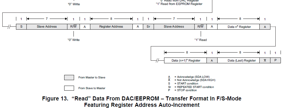

My customer is wondering if this part have the same transmission format with TPS85132?
Below is the capture from TPS85132
Can you help to let us know your comment or if there are further information needed?
Thanks a lot.
