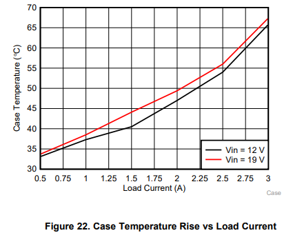

Customer would like to know what is case temperature while at max. 8A load current for Vin=19V/12V similar as below? Thank you.

Hi Patrick, For 8A full loading, run 10~20mins on EVM, 19Vin will be around 98C, 12Vin will be around 89C.
