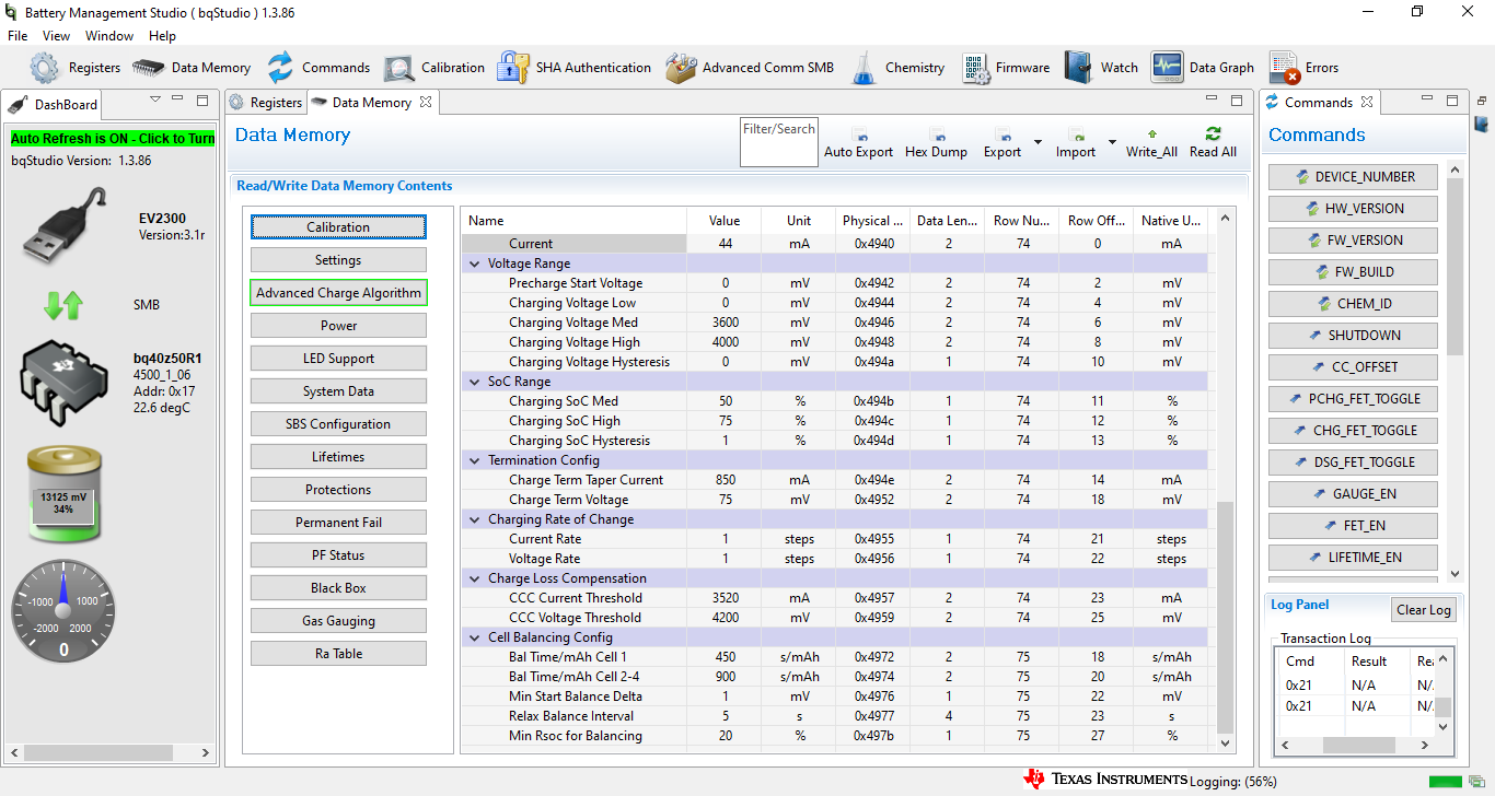

My configuration is CB and CBR =1 , REST=1,   min start bal delta=10mV, relax bal interval=5s, min RSOC for bal=20%(SOC is 83%) and update status is 0e

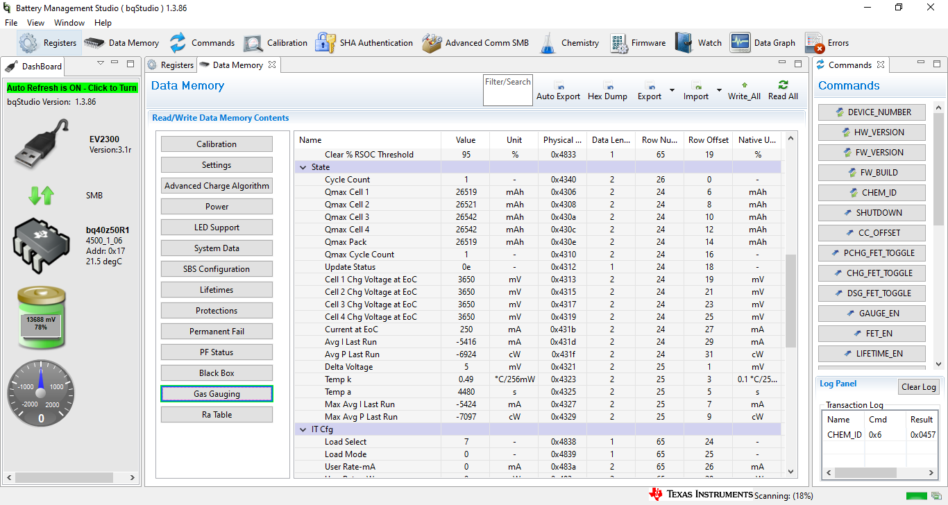

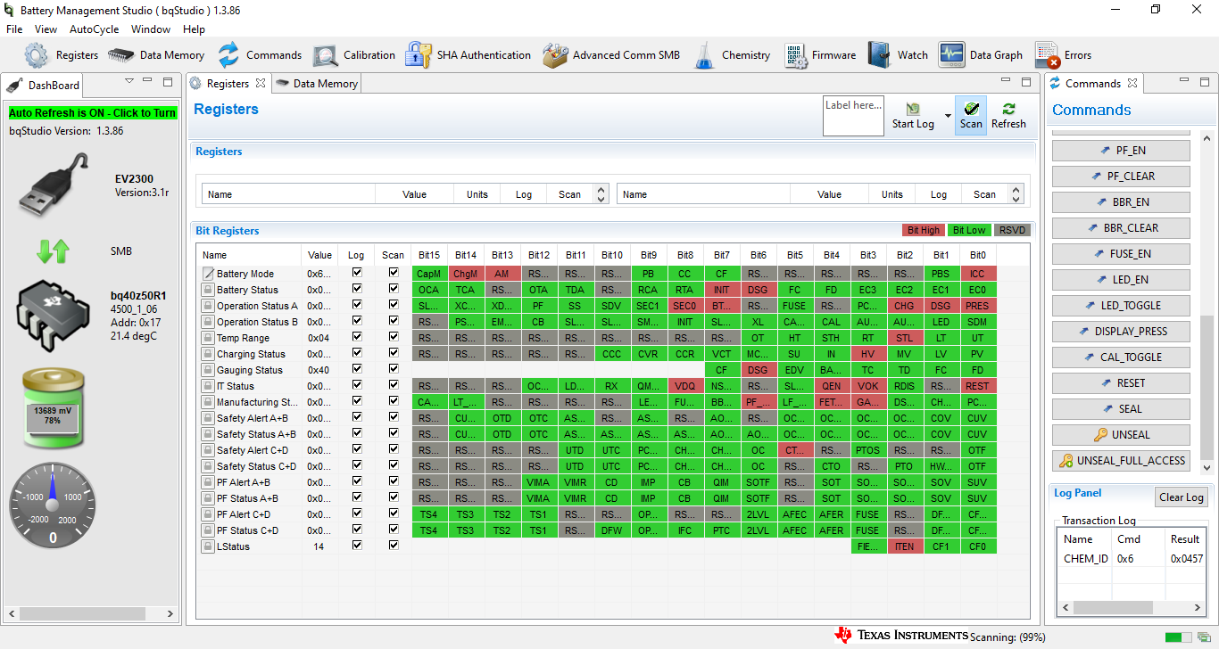

       Can you provide a screen capture of bqstudio when you think the balancing supposed to work but actually not?
       Also, please provide a log file of the register data during relax period from charging stop to DOD update?
       Please be noted that the balancing would not start until a valid DOD update has happened.
  • Hi Steven,
    FYI it's a LFP battery, I am playing with a prototype to learn how the BQ40Z50-R1 works. The cells are unmatched meaning at the end of the charge there is a big voltage imbalance. I am using external balancing.
    I fully charged the battery and I let the battery in relax mode waiting the flag REST=1 to see if the balancing at rest could correct the cells voltage difference.
    I think I clicked on the reset button, now the SOC reading seems not coherent.(it should be close to 100% but it 78% )
    Update status is 0e but Lsatus field Qmax stays at 0.
    There is Qmax cycle count but no DOD cycle count, is there a way to check a DOD update has happened?

        When DOD update happened, the VOK bit should change from 1 to 0. Meanwhile, you can also see an update on DOD0_x.
        Please do not send reset command after the IT is enabled, especially for a LFP battery, the voltage curve is very flat, a small variation on voltage reading would incur a big difference on DOD estimation.
        Please charge the battery to full again and leave it relaxed until you see the VOK bit cleared.

        VOK set means that the voltage is OK for Qmax update, it is cleared when a qualified DOD is read for Qmax update, the battery does not have to be fully charged.
        VOK changes from 1 to 0 during relax suggests a qualified DOD has been read.
        it is strange to see bal dod and bal time during relax with CB deactivated. I do not see this in your brief log file.
        But BAL_EN in GaugeStatus Register is clear, this indicates something is actually preventing the cell balancing to start.
        Can you send IT Enable command twice during relax see if the CB can set after this operation
  • Hi Steven,
    When REST switches to 1, VOK should switches to 0 ?
    I sent a GAUGE_EN two times  as you suggested( the battery was already at REST): The REST flag switched to 0 during few minutes and switched back to 1.
    I was able to see the balancing during 1 second (see the log file at elapsed time:36.263). The min balancing delta voltage at rest is 1 mV(see picture).
    I should be able to see a quick balancing for cell 1/3/4 even if the delta voltage is low?

  • Hi, Clement
        I think it might be caused by Relax Balance Interval is set too short, the default value is 18000s, do you change this on purpose?
