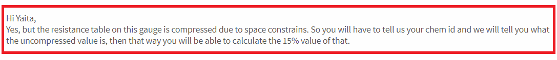

I am looking to calculate Ra Max Delta for the bq27510-G3, which is recommended by the datasheet to be %15 of Ra[4]. In a previous thread, it was mentioned that for some fuel gauges, the value is compressed:
Would it be possible to provide the uncompressed value so that Ra Max Delta may be calculated? I am using ChemID 1122 and after the learning cycle, Ra[4] is reported as -7.
Anthony
