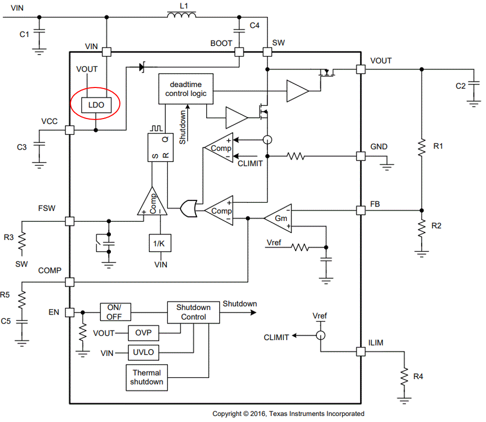

Does the internal regulator turn on by inputting only Vin?
I would like to check if TPS61089 starts when VCC pin is connected to EN pin.

Dear Sir,
TPS61089 can turn on by inputting only Vin. But the EN must be 'high' after the Vin applied.
If Vin>2.7V, and EN connect to Vcc, then it can be turned on.
