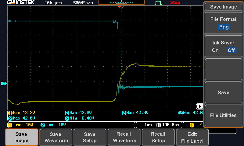

initially, I thought it is due to the minimum load issue for zvs. But the thing is that heating is increasing as loading got increased. Attaching the Vds and Vgs waveforms at 800W load.
blue is Vds(10X probe) 400V, yellow is Vgs. I think the miller plateau is still present. which means ZVS is not achieved. the case is almost similar for both the active and passive legs for 800 and 400W loads.
What will be the reason for this?

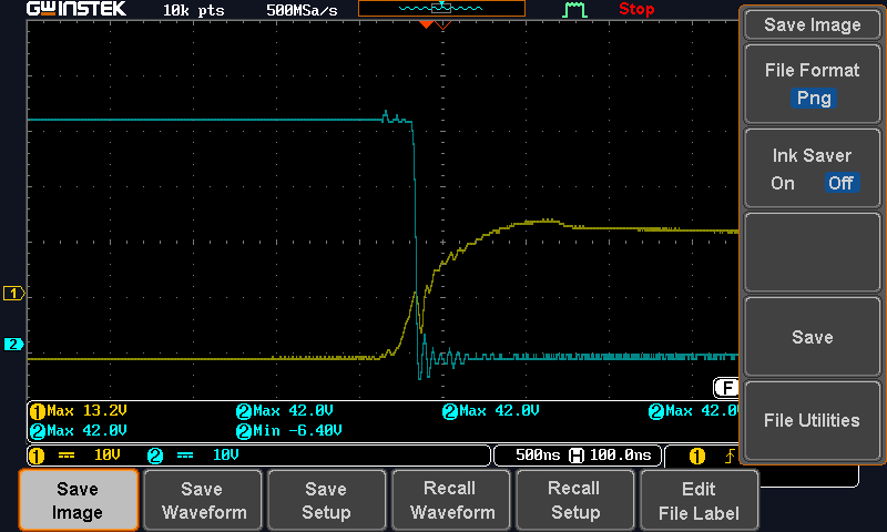

    Can you say anything about ZVS from the attached graph?
    Actually gate pulse is a bipolar signal, so w.r.t common zero graphs attached. as per the graph, Gate pulse is getting positive only after VDS became zero. So is this correct ZVS. Or we have to look into the first graph? ( Both graphs are the same, But in second both have common 0V)
    So can you judge anything on the ZVS from this?
  • Hi Nidheesh,
    Thanks for pointing out that the gate drive voltage is bipolar.
    If the Vds voltage across the device has collapsed to zero before the gate voltage has risen to the Vgsth then you have ZVS.
    In the waveforms above it looks like ZVS as the Vds voltage has fallen to 0V  and the gate voltage is just transitioning through 0V.

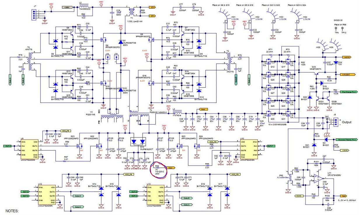

    But it is noticed that R98 is heating. What is the purpose of this R98?
    (my Output voltage is 60V and Vds of secondory MOSFET is found to be around 180V)
    Nidheesh
  • Hi Colin,
    I have read an article in which u described how to calculate R98 value. So in that, you are calculating 1/2 L/N I^2 for leakage inductance w.r.t secondary.
    I have Shim inductance of 10uH as leakage if so do I need to add this also to the calculation of 1/2 L/N I^2 or only transformer leakage inductance need to be considered?

  • Hi Peter,
    Here I am attaching the schematic.R98 is marked with a red circle.
  • Hello Nidheesh
    The resistor R98 forms part of the secondary snubber network along with the capacitors C64, C74, C75, C76. The capacitors will be charged through D13 by the high speed spikes on the transformer secondary waveform and the purpose of the resistor is to form a discharge path to Vout.
    Colin
