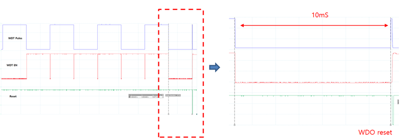

and toggling WD pin every 10mS.
When WD_EN pin  is low, WD pin toggling after 10mS.
Then WDO pin gose low ( MCU reset )
why dose WDO pin out to low ?

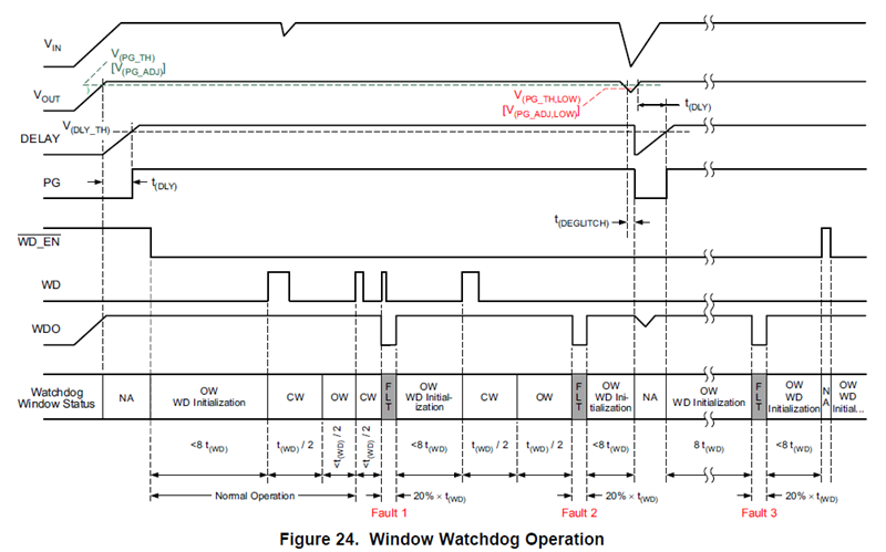

• Fault 1: The watchdog service signal is received during the closed window. The WDO is triggered once,
receiving a WD rising edge during the closed window.
• Fault 2: The watchdog service signal is not received during the open window. WDO is triggered after the
maximum open-window duration t(WD) / 2.
• Fault 3: The watchdog service signal is not received during the WD initialization. WDO is triggered after the
maximum initialization window duration 8 × t(WD).

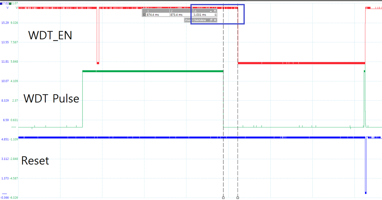

  • Hi Jinsu,
    As you described, the device is set to window watchdog mode with twd = 30ms. Assuming all the information provided is correct. The only case that may cause the WDO to toggle low is as follows:
    1. As soon as WD_EN toggles low, there is a WD rising edge immediately that happened to finish the first WD initialization process.
    2. After the initialization, it's in CW for the next twd/2 = 15ms. So a WD rising happens in 10ms could trigger the WDO to toggle low.
    I would suggest double check to see if there is any unintentional WD signal that may accidentally happen as soon as WD_EN toggles low.
    Jason Song
  • Hi jason
    As soon as WD_EN toggles low, My customer has checked  WD rising edge. but it isn't happened.
    Additionally after WD pulse went to low My customer gave WD_EN pin delay time for 1ms, but the WDO to toggle low.
    Let me know Why WDO to toggle low?
