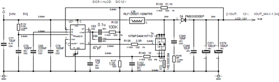

Following is the schematic:
Switching frequency is about 330KHz, Paramter of the components are:
Inductor: 10uH, 7.5A(max); CHF: 47pF; CFB: 0.1uF; RFB: 100Kohm; RIFLT: 1K; CIFLT: 220pF; Output capacitors: 10uF ceramic + 200uF OS capacitor (16SVPC100M, SANYO) ;
Input capacitor: 10uF ceramic + 220uF OS capacitor.

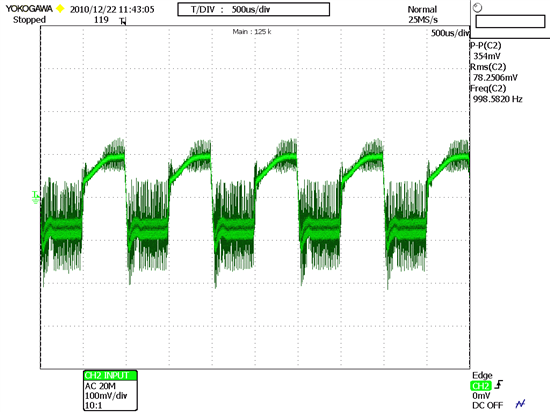

When adding static load (0A to 1.3A, any value), everything are OK: no noise, ripple voltage is very low (less than 200mV);
But when adding dynamic load, noise came out; ripple voltage increase a little, about 360mV. Picture of ripple voltage is attached below:
Thanks in advance.

    It is highly likely that you are generated the audiable noise because you are stimulating the circuit at 1kHz, which is a highly audiable frequency.  Your waveforms don't show any instability issues or audiable noise conserns other than the fundemental load frequency noise.

    The frequency of noise should be same as the dynamic load, as I when changed the load frequency, voice changed.
    I once calculated the compensation value according to datasheet, but with these values, the efficiency is very low and ripple voltage is high. Then I tried a lot of values, change components and found that 100K+0.1uF is the best one. I don't konw whether the noise has some relationship with this compensation circuit.

  • I don't konw whether the noise has some relationship with this compensation circuit.
    The compensation value changes the controllers response to the dynamic load, affecting the amount of ripple generated at the ouptut based from the load step, so yes, the compensation can affect the noise.
    What components did you change?  It sounds like you've implemented a dominant pole compensation loop with a 10ms time constant or about 300Hz bandwidth, which will result in the converter averaging the 1kHz load steps, allowing the output capacitor to smooth the output voltage and this would reduce the audiable noise generated by a inductor.
    Now I added 330uF aluminum capacitor on the output, noise almost dispeared. But the problems is I can't add more capacitor on the PCB as PCB size limited.
    The additional output capacitance is providing hold-up to the load.  At 1kHz, the load step is about 500us.  This would further reduce the bandwidth and average the inductor current through the steps.
