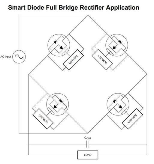

Hello team,
Are you able to rotate the fet's on the second half of this rectifier to avoid a diode drop of the fets?

Hello Julio,
LM74670-Q1 turns-On the MOSFET when drop across body diode of the MOSFET increses above 0.48V. SO the the drop across any branch of the rectifier will not increase beyond 0.48V and then MOSFET would turn ON. Please see section 8.1.2.3 and 7.4.2 in the datasheet.
Once the conduction starts through the MOSFET , LM74670-Q1 will turn-off the MOSFET in case of reverse current.
