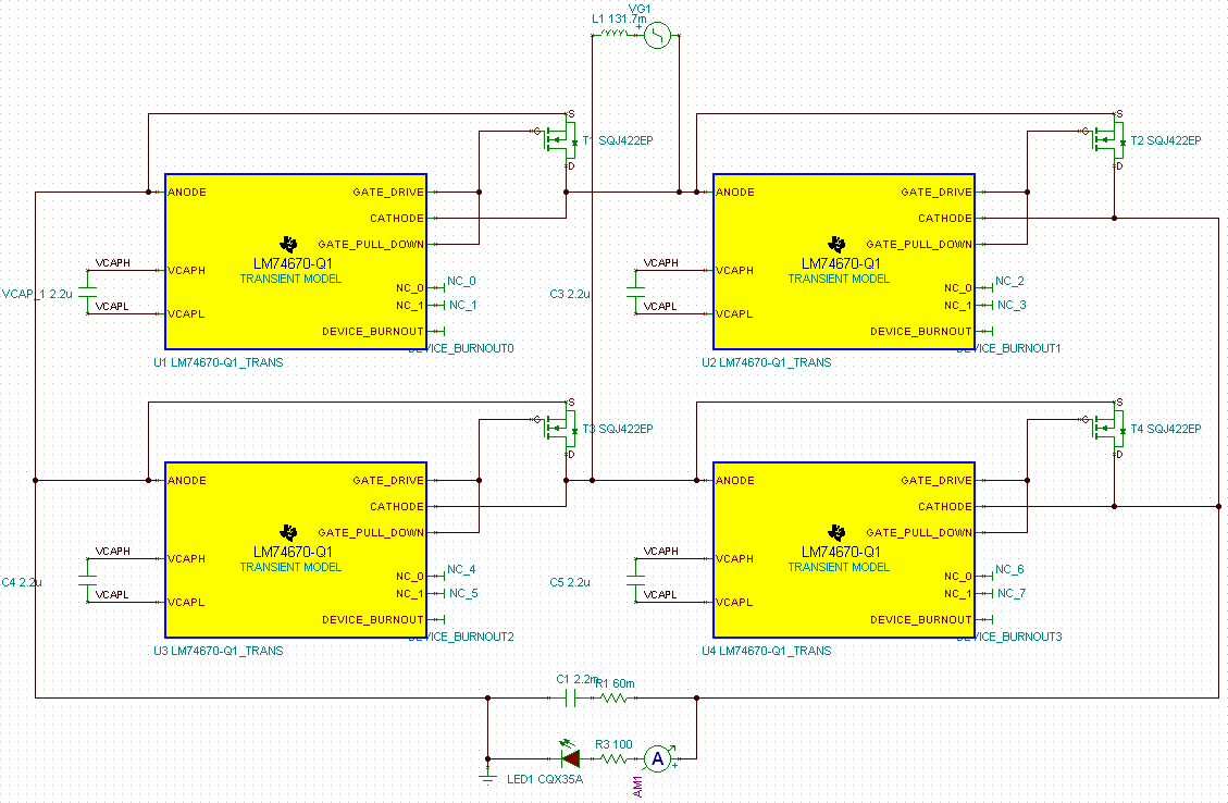

LM74670-Q1: TINA-TI MOSFET bridge simulation problem: Current of component: U1.E_E8
Part Number: LM74670-Q1
Other Parts Discussed in Thread: TINA-TI
Hello.
I'm new to TINA-TI and perhaps I'm doing something terribly wrong, but I fail to simulate a MOSFET bridge with the LM74670-Q1 controllers. Here is the schematic:
When I run a transient simulation I get the error:
Node: 4
Component/Terminals: 4
Here is the schematic file: /cfs-file/__key/communityserver-discussions-components-files/196/bridge_2D00_tina_2D00_w_2D00_lm74670_2D00_q1.tsc
Any help would be greatly appreciated.
Semyon
