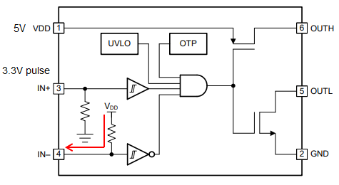

Hi team,
My customer is considering to use LMG1020 for GaN FETdrive.
The customer would like to control the LMG1020 with 3.3V MCU. In this case, customer is worried that a reverse current flows from VDD(5V) to IN- through an internal pull up resister. Therefore, the customer would like to keep the IN- to low level(GND) always, and they would like to drive the GaN FET by inputting 3.3V pulse to IN+. Is this usage acceptable?
According to the LMG1020EVM, the IN- pin is pulled down to the GND. Therefore, I think that the usage that the customer thinks can be used.
Yamaguchi
  • Hi Takashi,
    Thanks for reaching out about lmg1020.
    The inverting input IN- needs to be pulled to GND in order to enable the part. Grounding IN- and pulsing  IN+ to drive the Gate is how the part is driven on the evm and is an acceptable use of operation.
    Please let me know if you have any other questions.
