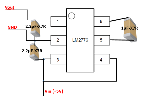

  • Hi Sadok,
    could you please give me some more information with regards to your application:
    1) Could you please share your schematic with me?
    2) Could you send oscilloscope plots for the input and output voltage?
    3) What has been changed between the scenario where you see -2.72V at the output and 372mV?
    4) Are you using the LM2776EVM?
    5) What is your load condition?

  • Hello Britta,
    Please find below my answers :
    I did not take curves
    I switched OFF the Input voltage, and then switched ON! The Consumption on the + 5V reached 67mA !!
    No I using the LM2776DBVR (samples from TI)
    I do not have any load on the output

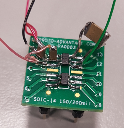

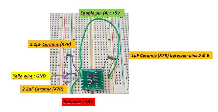

  • I can understand why you'd want to use a breadboard, but this necessarily breaks all of the guidelines in section 10 of the datasheet.
    If you don't want to design a custom PCB, you still have to put the capacitors as near the pins as possible; solder them directly on the legs of the LM2776.
  • OK I see, but what is the explanation about the consumption (more 67mA) on the power supply (+5V) and without load?
  • All the energy is lost in the parasitic resistances, capacitances, and inductances of the breadboard/traces/wires.

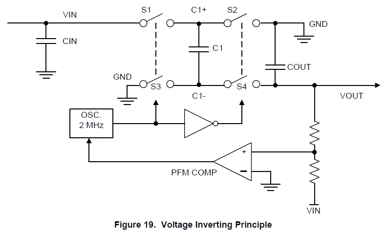

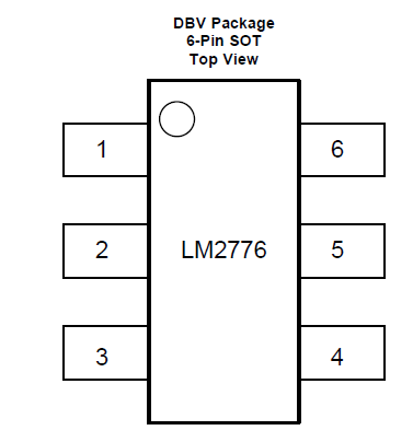

  • We have applied the requirements with capcitors mounted near the component. But we have alwyas the same behiavour as such a high consumption without load : 68mA under +5V and the output voltage is around 370mV!! We think regarding the figure19 in the datasheet, that the switchs S2 and S4 are ON always!! that mean the INput voltage is connect to ground!!
    Question, could you please confirm that the pin configuration regarding the datasheet and the picture of the sample, it's same? otherwise, could you confirm that pin1 is located on right top of the picture?
    Many thanks
  • The pin configuration is correct, and the same as on the EVM.

  • Hi Sadok,
    you mentioned that you now mounted the capacitors closer to the IC. Could you please share an updated picture and - if possible - also send a drawn schematic of your connections. I'd also recommend to check the connections with a multi-meter or oscilloscope to make sure the pins are connected to the desired signals.

  • Hi Britta,
    The capacitors closer to the IC.
    A drawn schematic of my connections.
    Also recommend to check the connections with a multi-meter or oscilloscope to make sure the pins are connected to the desired signals.
    ==> done and it's okay

    ==> After that we observed the over consumption (around 68mA on +5V Input power supply), we test by multimeter the connexion between pin 5 (C+)  and 2 (GND), and there is a contact between the both pins ==> it's a normal process regarding the following detailed schematic in the datasheet ==> we suppose that switch S2 is colsed and the connection between GND (pin 2) and C1+ (pin 5) and S1 is closed too ==> so a short-circuit between Vin and GND!! The voltage output do not exceed 370mV!!

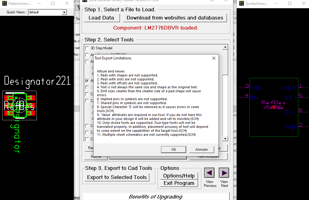

    Could you please send me the Altium Library (symbol and footprint) of the LM2776DBVR (DBVT).
    Many thanks

  • Hello Britta,
    The CAD/CAE symbols don't an answer for my request. Indeed, I need of the librairie (Symbol + footprint for PCB) of the component for Altium Designer.
    Thank you for your answer

  • Hi Sadok,
    did you check the instructions next to the CAD/CAE files? Those should help you generate files to be used with Altium.
    Britta

    Yes I apply the steps, but in finally I obtain this window with theimpossbility to generate the schematic symbol and footprint of the LM2776DBVR.
    Could you check please?
    Many thanks
    Sadok

  • Hi Sadok,
    you should be able to download the Altium files from the Ultra Librarian website, however you will have to create an account there.
    As I said before, there was NO issue with the lot you've received parts from.
    I'd suggest to have a further look at the circuit. Could you provide oscilloscope shots of the input and output rails as a start?
    In case you don't feel comfortable in sharing those Publicly I suggest to take this discussion offline.
    Britta
