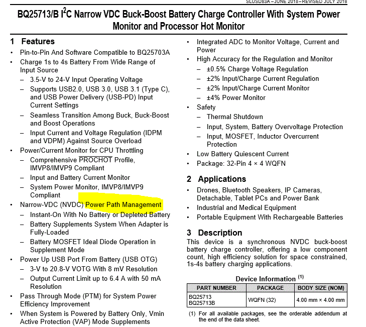

  • Great, I think this solved my questions but one more thing: how is the name of the hability to work without battery in a charger? I mean, I want to know how to look for it and know if a device can support it or not.
  • Hi Daniel,
         Generally speaking, our chargers all support no battery application. You can assume capacitor at VBAT terminal as a small battery.
         But I assume you are referring to the capability to support separate VSYS and VBAT. Basically when battery is depleted and charger still be able to provide a separate minimum system voltage to support system. This capability is named "Power path management" shown in our data sheet below. Hopefully this answer your question.
