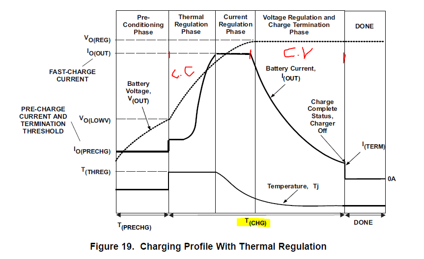

2.  Customer want to know CC mode to CV mode's timing.
   do we have the regarding data to provide ? or is there any calculated formula for reference?

    2.  Customer want to know CC mode to CV mode's timing. ---Bill J -- The timing between start of pre-charge and start of constant voltage is set more by the battery, not the charger.
