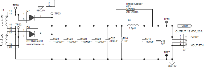

I have been dealing with the above mentioned IC UCC29950 for some weeks now. My basic application is 185-230VAC input and 260VADC output with a power up to 500W. At the moment I have the problem that I cannot control GD1 and GD2 in any way, as soon as I connect these pins to the pulse transformer 78602/9C or to the driver IC UCC27714. I have taken both possibilities from the reference description and from application instructions. It is therefore not a self-invented design.
Meanwhile I have passively adjusted the feedback pin regulation by setting a fixed voltage value of 1.5V (by means of a voltage divider on the primary side), so that I just want to have a fixed switching frequency. Furthermore I proceeded by removing (C4022, C4012, R4011, R4019 --> see wiring diagram), so that I have no energy transfer.
The effect of the circuit is as follows:
As soon as I disconnect GD1 and GD2 from the output stage, the PFC stage is active and GD1 and GD2 are generated with a fixed frequency. Once the power stage is connected, UCC29950 is directly inactive. It doesn't matter if the transformer T4001 and C4022+C4012 are connected or not.
First I assumed an overload of the drivers. This case has not been confirmed. I also checked the active components.
Here they have the two necessary files, which I send them. If you have any questions, please do not hesitate to contact me.
LLC Power Stage.pdfUCC29950 Stage.pdf

    Thanks for getting in contact. I've had a look at your schematics and one thin I see is that the output capacitance for the LLC stage is very low - C4015 is only 470nF. Normally at this power level one would need several mF to absorb the ripple current, for example if you look at the EVM for this device we have used 4300uF. You don't show a value for L4003 but assuming it's a common mode choke, it will still have a significant differential mode inductance. This will force most of the secondary ripple current to flow in C4015 and will generate a very large voltage ripple across it. I'm not certain how this would affect the controller, perhaps the LLC_CS will trip but I'd advise you to move the bulk of the output capacitance to the left hand side of L4003.

    The first point is very interesting for me and I will try it in the next days directly. I didn't think about the differential part of the Common Mode Choke, but it sounds conclusive. This is the 744824622 choke from Wuerth.
    It always looks to me as if the LLC level starts briefly at the beginning, but then remains inactive. The switch-off after the description in the data sheet would support your thesis with LLC_CS. I have chosen the size of the electrolytic capacitors so, because in the end I will have an extreme capacity by batteries. In your opinion, should 4300uF still be dimensioned independently of the load on the output stage? This would mean that an idle operation would cause problems, which I can't imagine, because the capacity is dimensioned to the nominal ohmic load. As I said, in my case it is rather extremely capacitive.
    Apart from that I don't have room for a 4300uF/450V capacitor bank.

    I was wrong about the capacitance you need - I forgot your output voltage is 260Vdc and not 12Vdc.
    Common mode chokes always have an amount of leakage inductance and this is the inductance that appears as a differential inductor. Sometimes, indeed usually, CM chokes are deliberately wound so as to have a significant amount of leakage inductance. Anyhow, your best option here is to talk to Wurth.
    The excel calculator for the UCC29950 gives a ripple current of about 2.14A in the output circuit of the LLC at 260V and 500W so you will need enough capacitance to be able to carry this current and keep the ripple voltage to reasonable levels. Assume you want to have 5Vrms ripple when running at resonance of 120kHz then you will need about 55uF or so of capacitance. The output inductor then forms a second stage filter so that the ripple current into your battery load is acceptable. Please double check these numbers using the device excel calculator - you can find it on the device web page.
