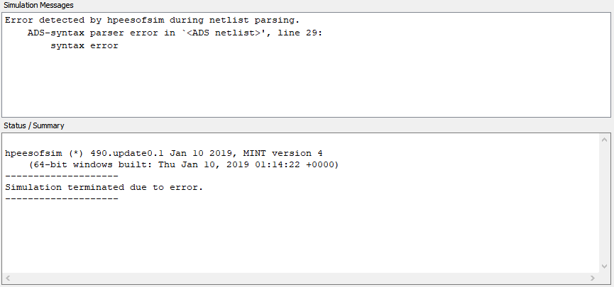

I am trying to use LM5112 spice model in Keysight ADS but it sais it has a syntax error.
I read in one of the threads here that it is due to bad translation off switch models in ADS.
can you provide an updated model for ADS, please

    I am able to import the model but when I try to simulate it sais there is a syntax error in line 29
    Yes, I have downloaded the unencrypted PSpice model

  • Hello
    this is the error I get in ADS
    and I have attached the netlist

  • Hi ALexander,
    Can you please share the .net netlist showing line 29. I ask because line 29 on the PSpice netlist from our model is a comment line.
    Seeing exactly what line 29 looks like on the ADS code (after you import the model) will be helpful to figure out root cause.

  • hi
    is this what you are looking for?

    .subckt FET simulation_lib:INPUTHYST_BASIC_GEN:schematic SUPPLY OUT CN+ CN-  _M=1 VTHRESH=2.5 VHYST=0.5
    .ends FET simulation_lib:INPUTHYST_BASIC_GEN:schematic
    .subckt FET simulation_lib:cell_1:schematic
    DDIODE1 _net4 _net17 DIODEM1 m
    RR2 0 _net17 1 M $.model $W $L
    RR4 _net17 VDD 200 M $.model $W $L
    VSRC4 VDD 0 4.2
    xX3 _net4 _net4 _net4 _net4 _net4 _net4 DMC1030UFDB_lib:DMC1030UFDB:schematic m=1
    xX4 _net16 _net1 _net13 _net15 _net5 _net2 FET simulation_lib:LM5112:schematic m=1
    .ends FET simulation_lib:cell_1:schematic
    .end
  • Hello Alexander,
    Thanks.
    It looks the error occurs on the line of code below:
    "xX_U12 N14862041 N14869697 N14859687 IN_REF FET simulation_lib:BUF_DELAY_BASIC_GEN:schematic m=1 VTHRESH=6 DELAY=2.5e-08" please confirm.
    I don't currently see the syntax error associated with that line of code along with the "FET simulation_lib:LM5112:schematic" sub-circuit but I am will further look into and get back to you within 24 to 48hrs.
    -Mamadou
