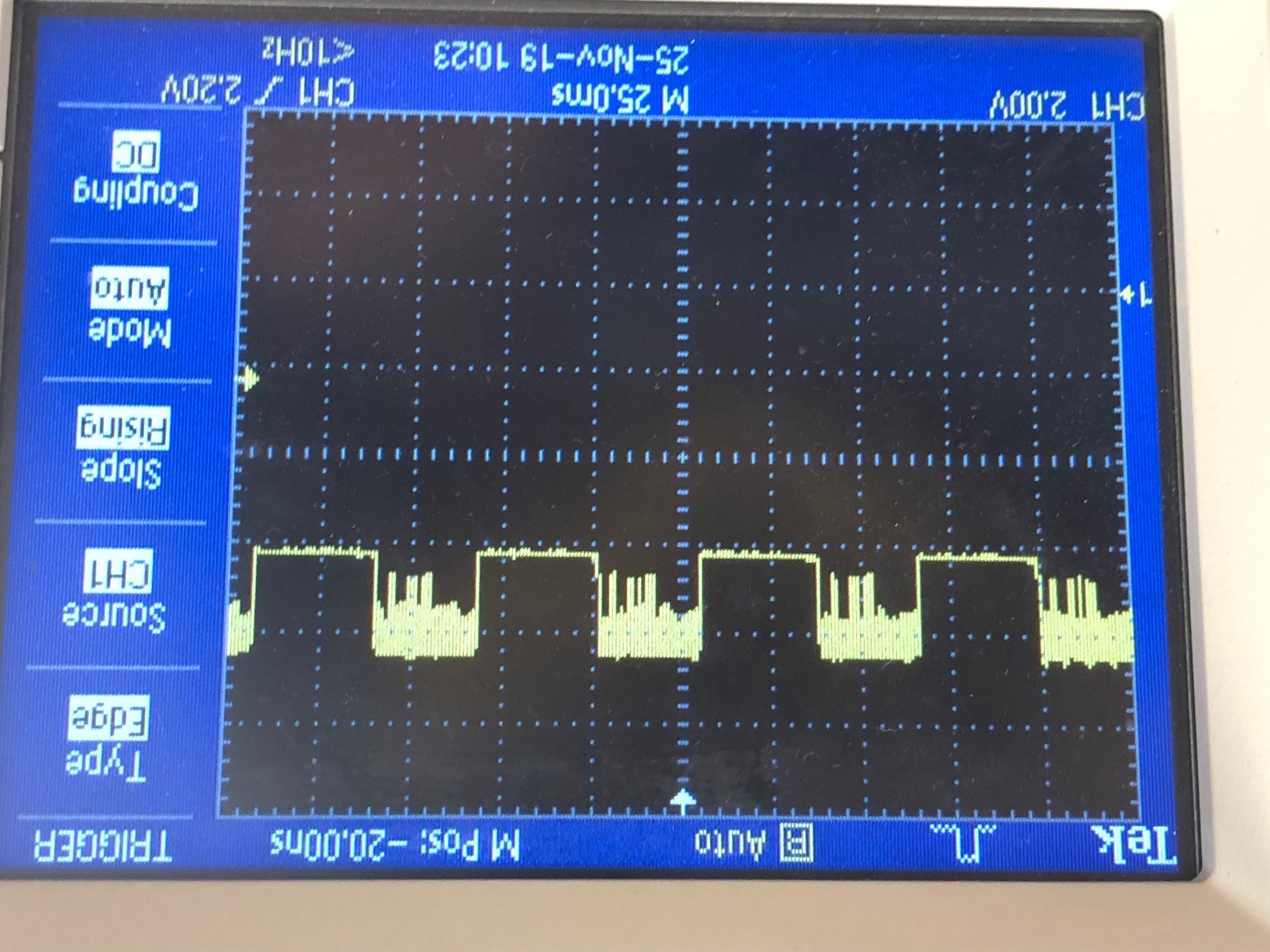

    Also, as mentioned in the first post, we are experiencing an issue charging batteries at 40mA using the BQ51050B unit. Below is a trace of the output (pin 4 BAT) when connected to our 40maH LiPo battery - is this what you would expect?

    Also, as mentioned in the first post, we are experiencing an issue charging batteries at 40mA using the BQ51050B unit. Below is a trace of the output (pin 4 BAT) when connected to our 40maH LiPo battery - is this what you would expect?  Bill J Nov 24 -- The BQ51050B is designed to charge 1A, it will not scale down well and charge / termination accuracy is poor at 40mA.  Take a look at reference design TIDA-00318 for lower charge currents.
    The scope capture does not look right.  Can you send a scope capture of RECT pin.
  •  Hi Bill,
    Please disregard the trace in the previous post.
    The output (BAT) from a faulty unit looks like the first image.
    The output of RECT from a faulty unit looks like the second image.
  • Hello
    the RECT in last post does not look correct.  Voltage is over 8V for then drops to 6V.  The on time does not look correct this is 25mS time base.
    could you double check.  Should look more like attached.

  • And this would look similar on a BQ51050B system?
  • Yes -- the start up is the same.  After start up the voltage will be a lower but you should see the same control error packets.
