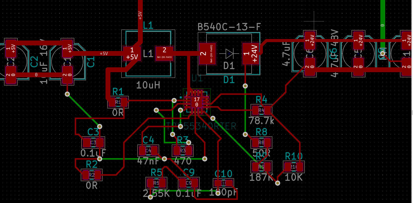

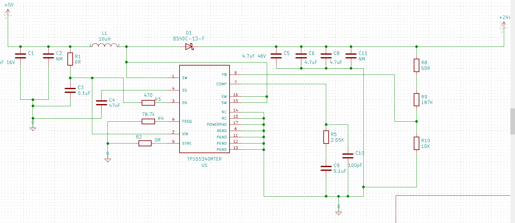

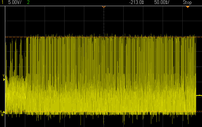

I have a problem with TPS55340RTER
I copied the crcuit in page 13
Vin:+5.2V
Vout: +24V
enable: 0    +4.7V

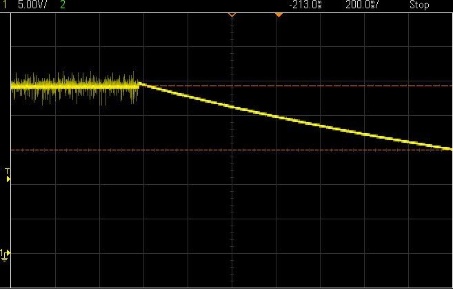

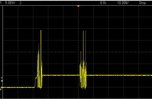

Sometimes happens when the enable up   to 4.7V the regulator remians disabled (Vout = 4.9V) Sometimes it increases the voltage for some 100msec and (until 10V or more) but after backs to VIn (disabled)
I tried to power on with or without charge with the same result.
