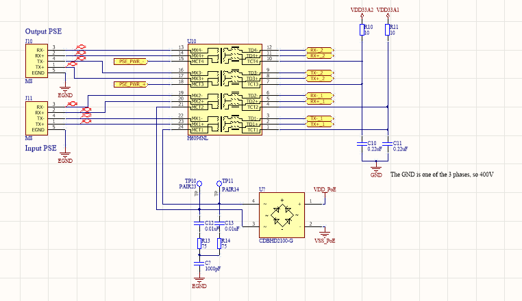

  • Hello Michael,
    First, I would like to apologize my late response. Below, my schematic around the audio/signal transformer :

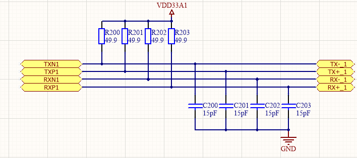

    I have to do like this because it simplifies the diagram of the sensor. Ethernet data is connected to a switch (LAN9313-NZW) with the following schema :
    This GND is the same as the first schema. So my question is :
    Is inside the audio/signal transformer (H6096NL), the GND will be a problem ?
    I hope my explanations are clear and thank you for taking time for that !
    Matteo Baldi
  • Matteo,
    Thank you for the clarifying pictures. The IC has a reference labeled RTN. Keep this ground separated from GND pictured above. The 400V GND should be isolated from the rest of the board with Bob Smith Planes / Terminations.
    Additionally, just making sure the input transformer can handle the voltage on the lines along with the capacitors connected to the ground. Otherwise this should be okay.
