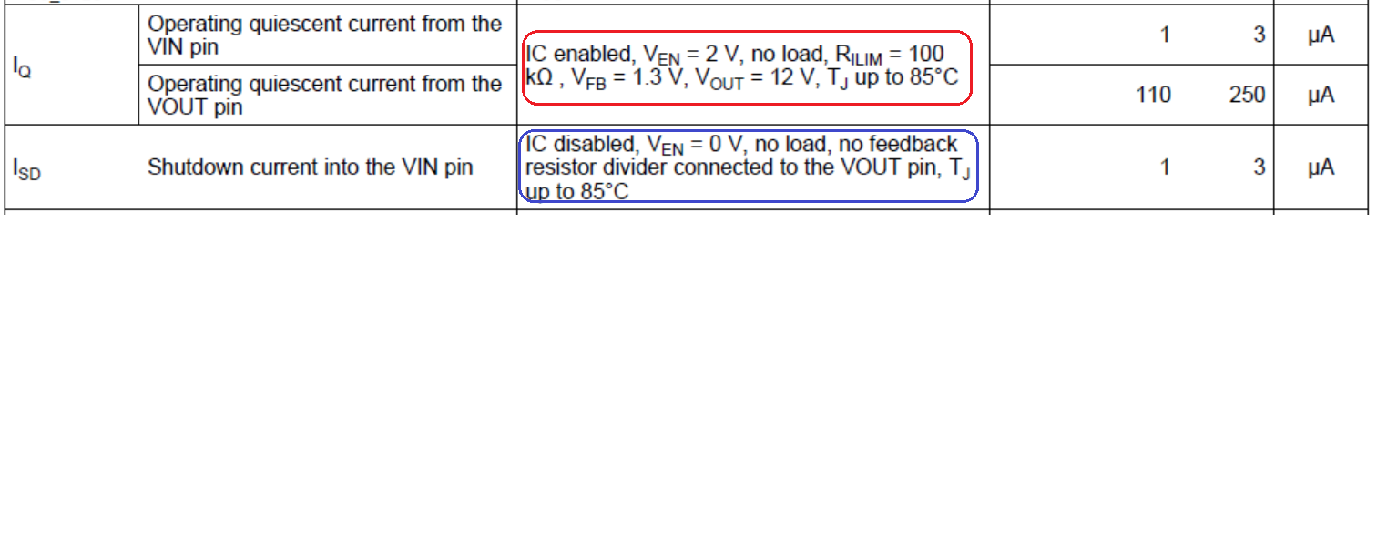

TPS61088: I have some question about Shutdown current .
Part Number: TPS61088
Dear TI team:
     We used TPS61088 for 4.2V boost to 5V application.  When we pull low EN PIN, Shutdown leakage current is about 50uA, but the spec describes the quiescent current is 3uA into the Vin pin. There is a load switch at the output of the IC that is off.
    Why is the difference between the specification and the actual test value so large?   Please help explain and give a suggestion, it is very urgent . thank you!TPS61088 Circuit.docx
