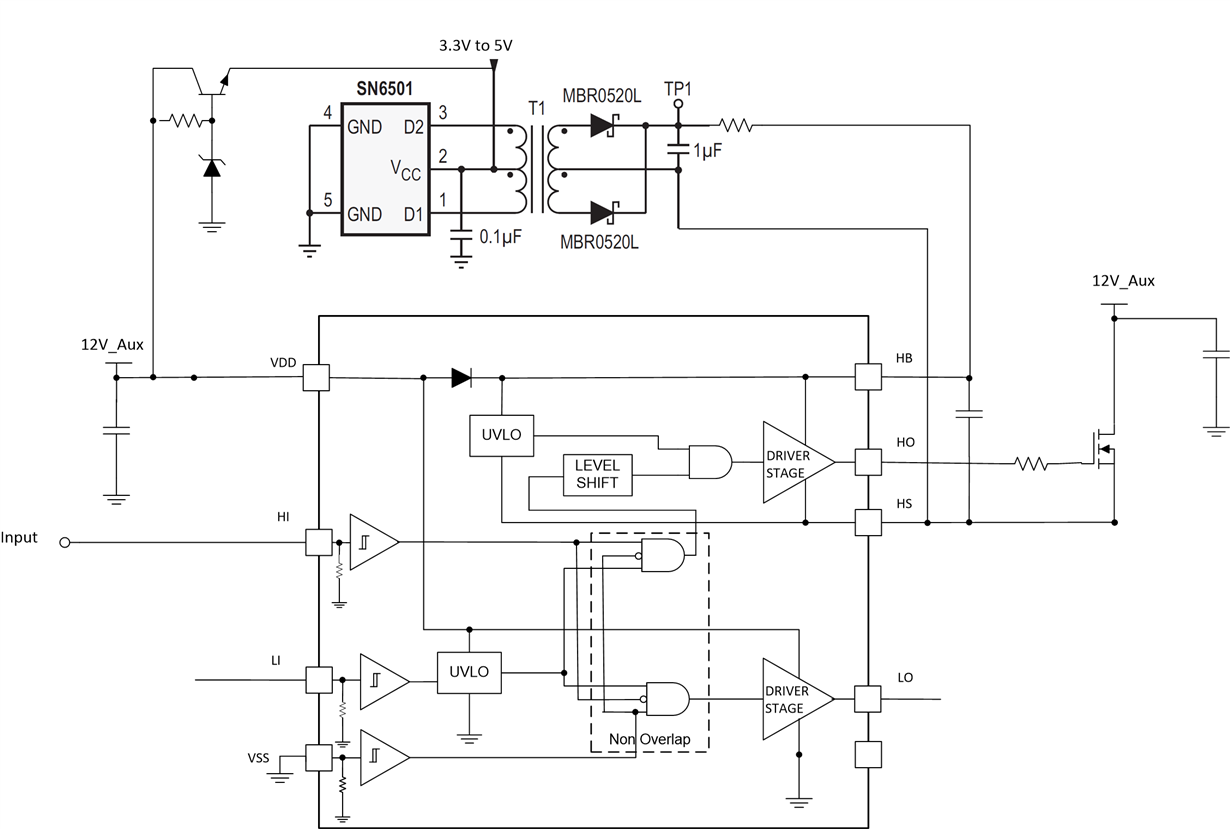

IRS21850S seems going EOL. I found UCC27714 but it is harf-bridge gate driver. Is there any better device for this?

    It looks like the IR device is a 600V dedicated high-side driver with 4A drive current. While we don't currently have a p2p solution, our closest candidate will be UCC27714, UCC2712 while using an isolated floating bias to supply the high-side gate.
    You can accomplish this using SN6501 + a small transformer as shown below.
    Please let us know if you have additional questions.
