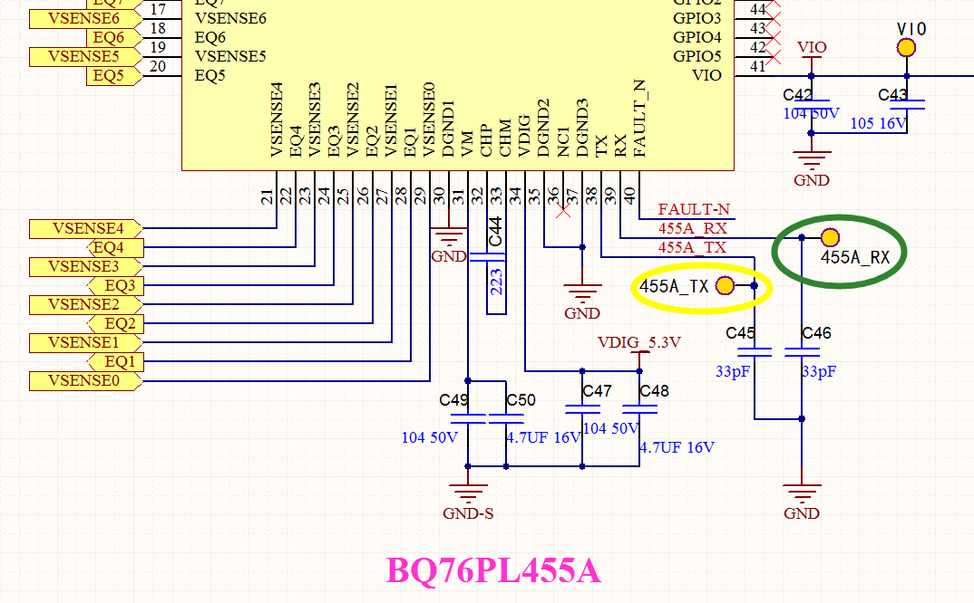

During mass production, individual BQ76PL455A chips return a packet in two parts and appear continuously, resulting in communication errors.

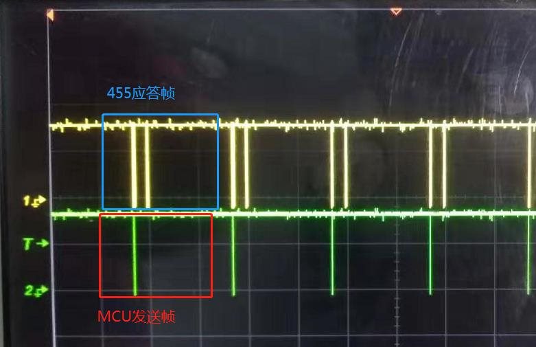

Error data waveforms such as pictures, when the MCU is sent, the data returned by 455A is continuous.
Now in bulk, individual boards appear to return data discontinuity, if the return of two parts of the data stitched together, the data is correct.

    • On the waveform above, what are these signals / where are they measured? Please label them.

    1. The test label is shown in the figure above. The color is consistent with the oscilloscope waveform mentioned above.

    Oscilloscope detection: the return data is divided into two reply packets, the first one is 2ms, the second one is 0.5ms, and the interval between the two packets is 12ms.

    I also recommend to zoom into the actual data in the oscillscope to read the data byte by byte and see what's happening before and after the 12ms interruption in data transmission.
