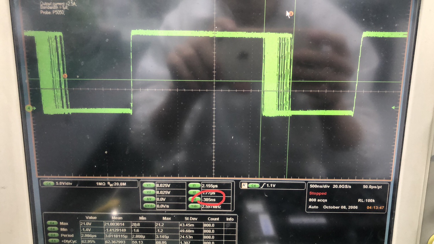

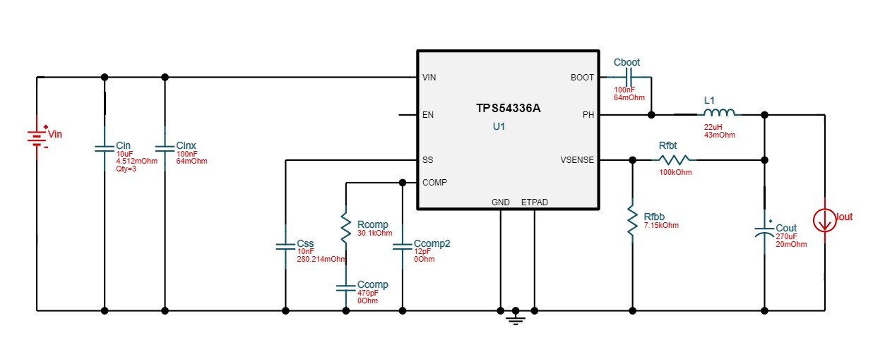

My customer use TPS54336A to design their system.
Vin=15V Vout=12V/2A but they found output voltage jitter is too big.
Previous design they use ceramic output cap but now they use os-cap.
So could you advise how to reduce the jitter? How to fine tune compensation component to reduce jitter as well?
