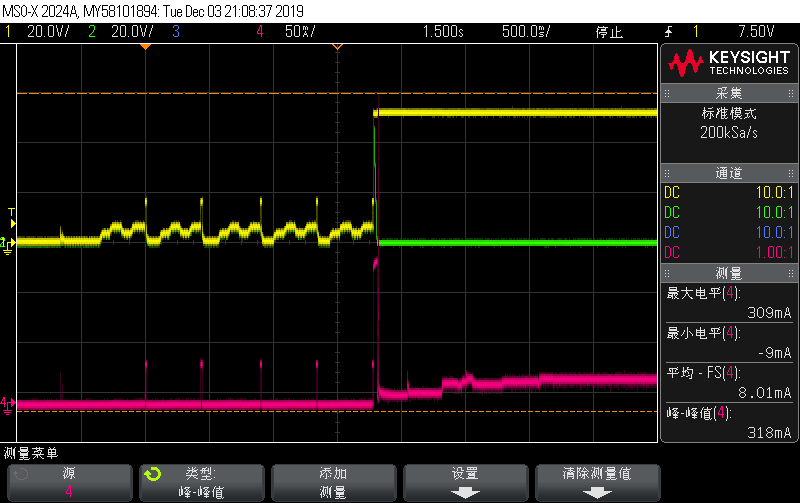

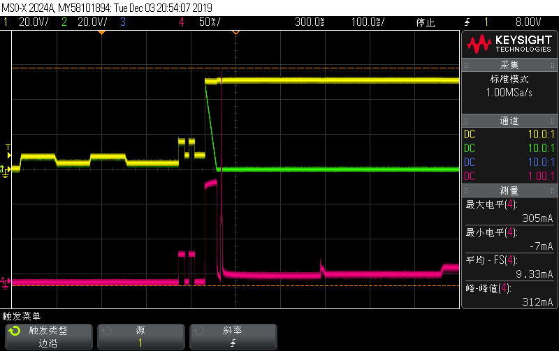

Customer met detection failure issue when connect with different brand switch. Huasan,TPLINK,NETGEAR could connect well with TPS23754, but Ruijie switch need nearly more times to connect well. Please reference the detection process with Huasan and Ruijie.
Huasan:
Ruijie:
Do you know the PSE solution of Ruijie? Will this influence the detection process?

Hello Sammi,
As discussed offline, we agreed the next step is to raise the VC cap. Additionally, change the capacitor value on VDD-VSS.
