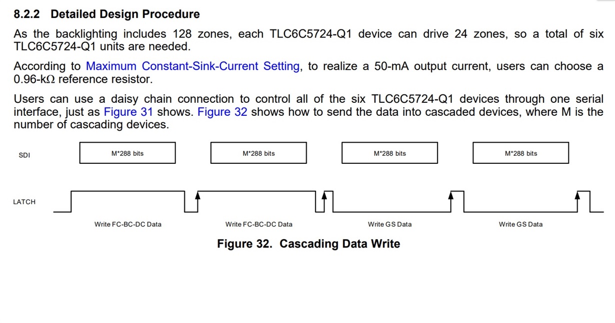

Dear Sir,
according to datasheet figure 32. Cascading data write, why FC-BC-DC or GS Data need to write twice? thanks.
