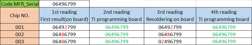

Finally, there is about 20% fail rate that MFR_SERIAL not match.
We use TI funsion to read 3 pcs fail MB and result is also fail.
Then, we remove 3 pcs fail parts from our MB and read MFR_SERIAL through TI programmer board, their "MFR_SERIAL" are all correct.
So we take those 3 pcs and resoldering to our MB then reading through TI funsion, their MFR_SERIAL still wrong.

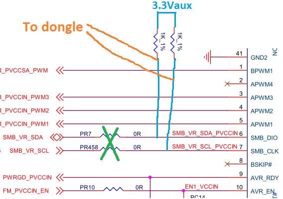

We already disconnect the PMbus from our MB PMbus and only read TPS56358 but the result still fail. (refer the following picture)
What is the cause of this result? how can we fix it?
Is there any other way to judge the programming data?
Following is 3pcs reading record and 1st&3rd comparison result
1st & 3rd reading_Device Configuration Comparison.xls

  • Hi Chasel,
    1. After reprogramming by TI GUI, the issue can be fixed.
    2. We had sent 8 fail parts to 3rd party. They re-verify checksum are correct. Then we send it to our FAE. Programming board reading still correct.
    3. We do the action described on the forum. We found reading single-chip always correct and reading on MB may be different. It is very strange...
