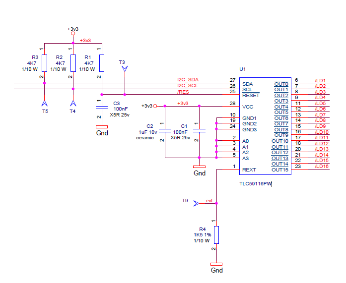

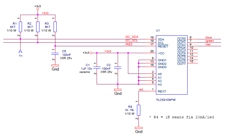

In my application, I'm using one TLC59116 16 channel led driver and one TLC59108 8 channel led driver.
There is a Main PCBa (microcontroller + power supply + ...), a Top PCBa (TLC59116 with 16 led) and a Bottom PCBa (TLC59108 with 3 ledl), connected with 80mm cables (not shielded).
The IC led driver are supplied @+3v3 and the led common signal @+5v.
Following you could find the schematic.

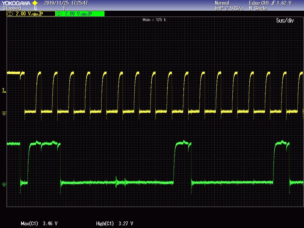

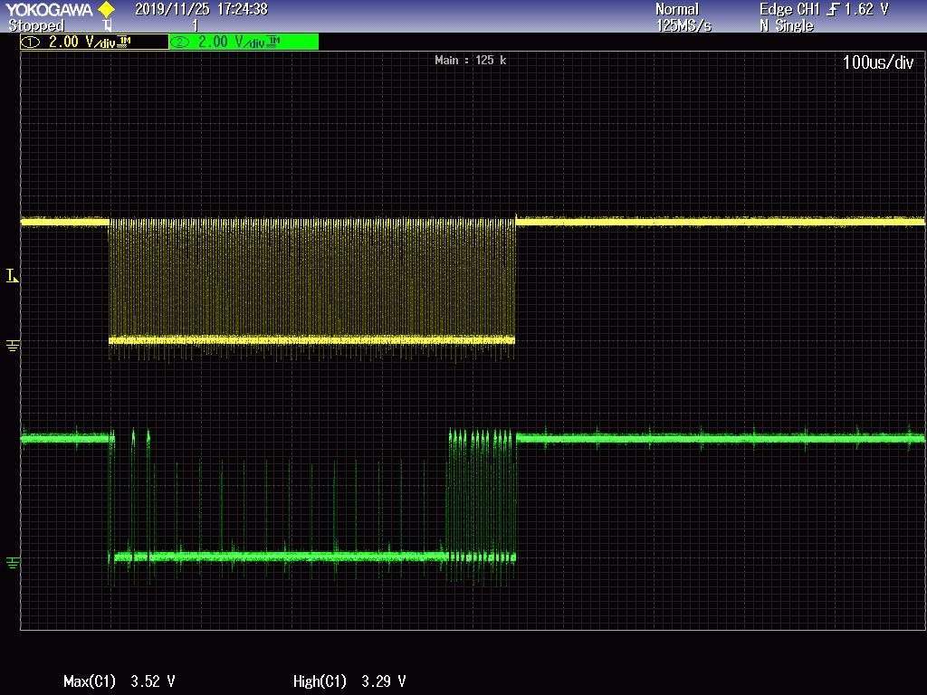

During the EMC test (Fast Transient Burst), I encountered a problem where, the comminucation between the MCU and one of the two led driver (the TLC59116), was blocked.
Only removing the main power supply e power on again, the system started to worke correctly.
What I would double check is, if the pull-up values on SDA/SCL/RESET signal are correct, if the capacitor on the IC main supply are correct, if I need to add something else to protect/get more robust
the configuration. Please note that, for the SDA/SCL I2Cbus signal, I used two couple of pull-up ressitor (one copule on the first IC driver and one copuple on the second IC driver) so, the final pullìup
ressitor value was 4K7 // 4K7  =  2K35
