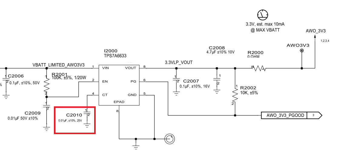

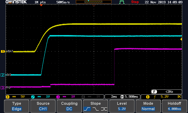

I've measured the Vout vs Powergood timing as attachment, and the delay time is about 7ms. My delay capacitor value is 0.01uF, I am not sure if the result is good or not. Because from the equation: Tct=Cct*1V/1uA, the Tct should be 10ms.
By the way, the EN pin pull-high resistor to Vin is 100k ohm, is it too high?

    The results you are seeing are as expected. While equation 1 in the datasheet shows the charging currents as 1uA:
    the4 actual typical value is 1.4uA:
    If you use this for the denominator of equation 1, you get ~7ms.
    The 100K resistor pulling up Enable should be fine.
