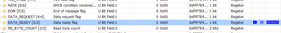

  • Thank you for your information! However, I want UCD3138064 as the host. UCD3138064 is configured to accept 2 bytes of data after sending a read command to the slave. My doubt is, can I use the DATA_READY flag to determine whether the read is successful, instead of the EOM flag? Because, I need to judge whether the current slave is damaged. If the slave is damaged, I need to handle the fault. If only the EOM flag is used, how can I judge whether the slave is normal? When I debug, I use the host computer to check that RD_BYTE_COUNT in UCD3138064 is 0, but there is data change in I2CRXBUF. Why is this? The IIC related code is as follows:

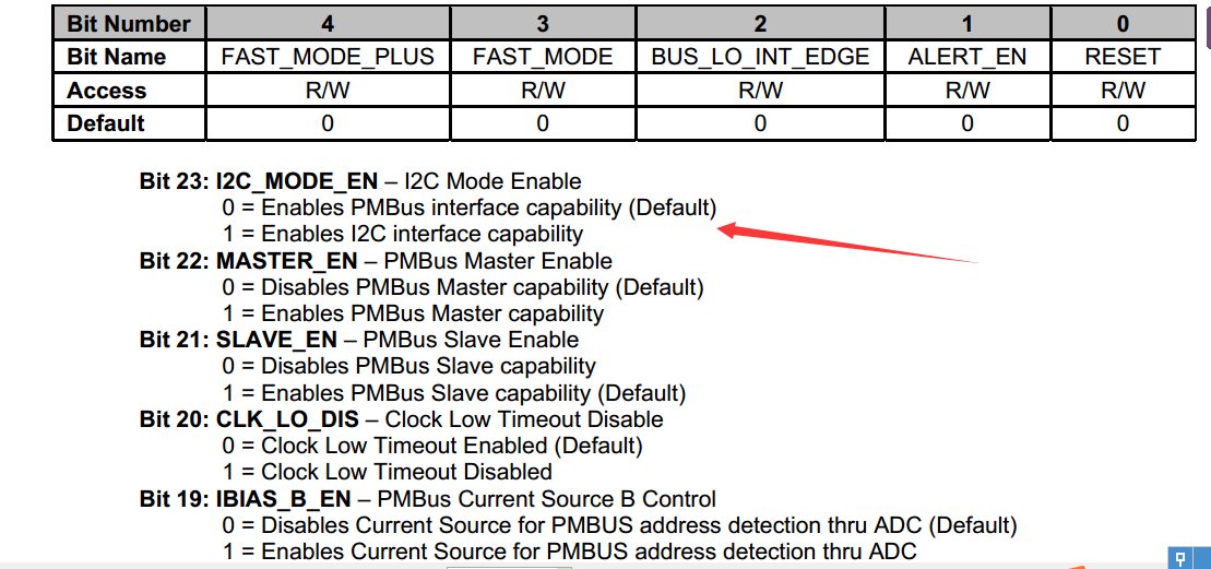

    In addition, by looking at the UCD3138064 Enhancements Programmer’s Manual, the I2C_MODE_EN of the I2C Control Register 3 is set to 0 by default, but when I set it to 1, will PMBUS be affected? As shown below,
  • OK, now I'm really confused about what your question is.  I assume that you are using the PMBus interface for the communication between the UCD and the master, and you are using the I2C interface for the communication between the UCD and the temperature sensor?  If not, please let me know.
    If my assumption is correct, then I can say that there is no connection between the I2C interface and the separate PMBus interface.  Just as a note, the I2C interface on the 064A doesn't do slave mode at all.  So you definitely want to set the master bit.
    I've already described what sets the data ready in the slave mode.  I haven't looked at master mode, but I expect it is similar, except the master is controlling more.
    I have no idea about why things are changing in I2CRXBUF.  If there's no EOM, maybe the hardware is collecting data, but doesn't feel the need to send it yet, because there's not an EOM yet.  A scope shot of what is happening on the PMBus when this happens would be very helpful.
    What do you mean by the temperature sensor is normal?  If it's not ACKing, I would expect the NACK bit to be set.  If it's ACKing, but stretching the clock, then I'd expect the CLK_LOW_TIMEOUT bit to be set in I2CST.  The clock low timeout doesn't get set until the clock is stretched for 35 msec.
    Does everything work OK if the temperature sensor is working correctly?  If so, please send a scope shot of the whole message sequence for that as well.
