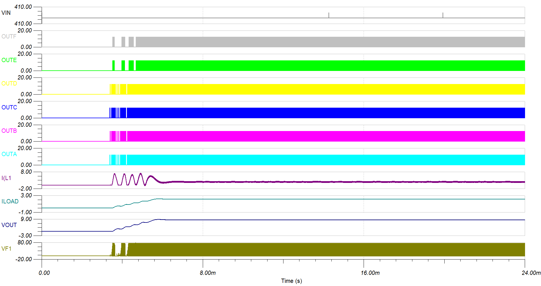

  • Hi John,
    Good day to you. Thanks for looking into the issue I am facing and prompt reply.
    I am currently modifying the transient model available in TI website. I am trying to modify it to 30V, 20A and 60V, 15A respectively. The modifications did are as below.
    Transformer turn ratio, transformer LM, Lshin, Lout, Cout, R at current sensing transformer and also the R and C into EAN and COMP.
    I had uploaded the schematics changes I did for 30V and 60V respectively in the link below.
    https://gofile.io/?c=wVoj53
    In addition, below are the simulation results from the schematics uploaded.
    Simulation for 30V :
    Simulation for 60V :
    You can observed that I put a probe at the transformer secondary winding (labeled VF1). Although I did change the transformer turn ratio according, but I am getting the same level of outputs for 30V and 60V. In addition, the Vout for 30V is as per expected, however, for 60V, the Vout only measured at 9V.

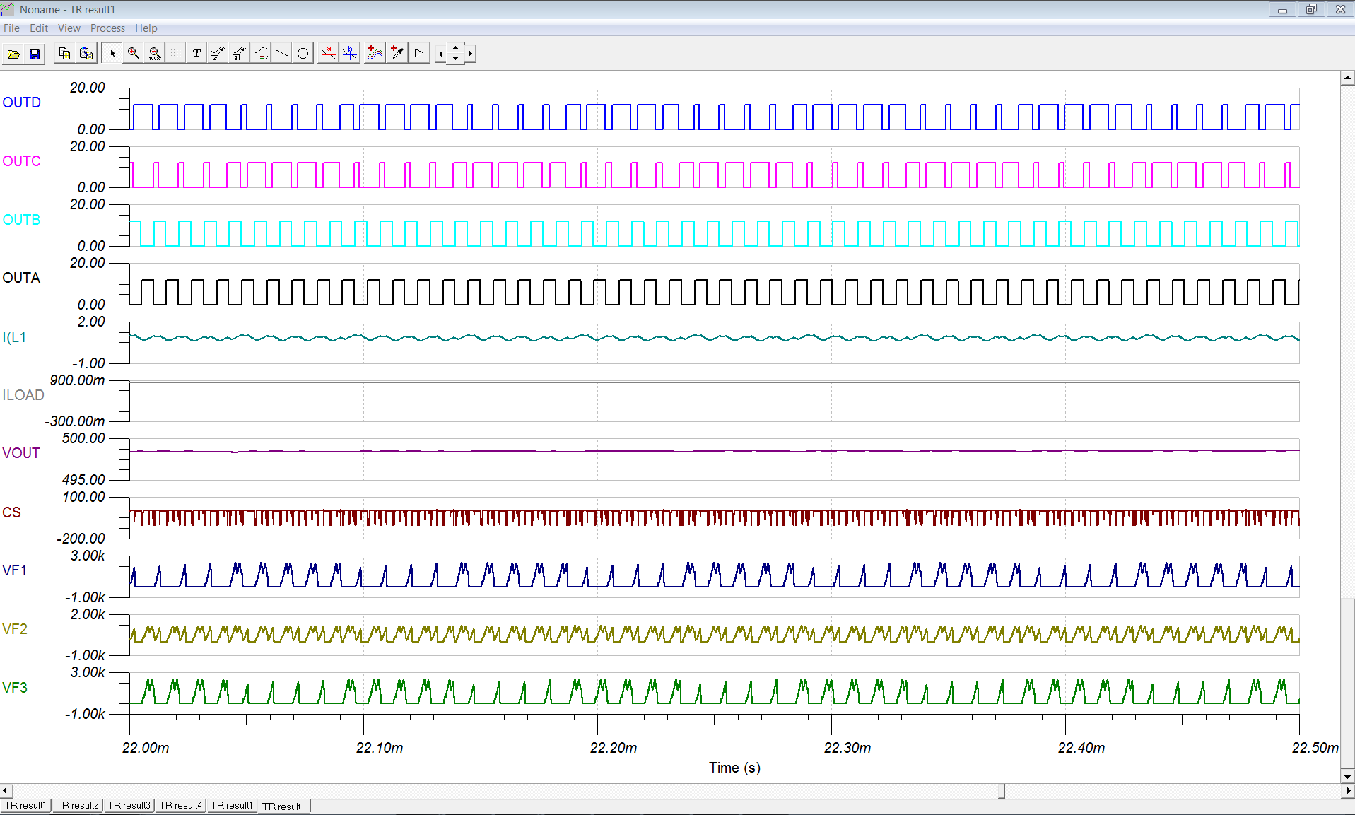

    I already resolved this issue. However, when I am trying to step up the output voltage to 600V, the simulation is not working again.
    The Output C and Output D is no longer 50% DC and the Vout I get is 500V.
    In addition, the voltage of EAN also showing 2V instead of 2.5V as expected.
    Do you have any idea why is it so? The simulation result is as attached.
    Thanks.
