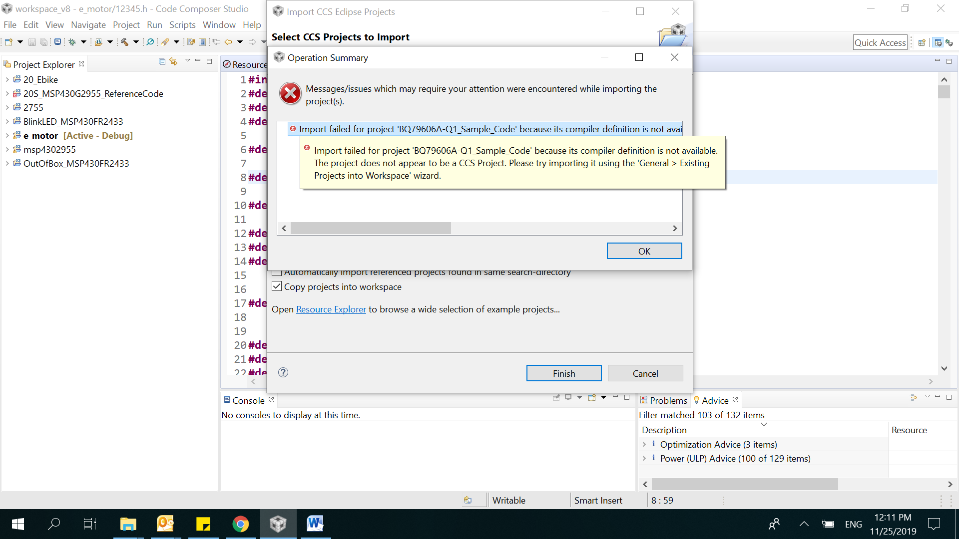

I download "BQ79606A-EXAMPLE-CODE: BQ79606A-Q1 example code of automotive battery pack applications" on ti.com. When I open this project by CCSV8, there is a failure and the error information is as below. Could you please help solve this problem?

  • Hi Sophia,
    Did you unzip the folder before attempting to import the project? Ensure you do this and then import the master folder instead of the directory inside the sample code folder.
    Taylor
  • Hi Sophia,
    Thank you for your question. I was able to open the project without issues. Did you maybe forgot to unzip the file? Please try again following the steps below:
    • Download the zip file
    • Unzip the file and save it to a known location
    • Go to File > Import > Under "Code Composer Studio" select "CCS Projects" > Next
    • Browse to find location of folder "sluc682" and select it > ok
    • Under "discovered projects" put a check mark on "BQ79606A-Q1_Sample_Code" > Finish
