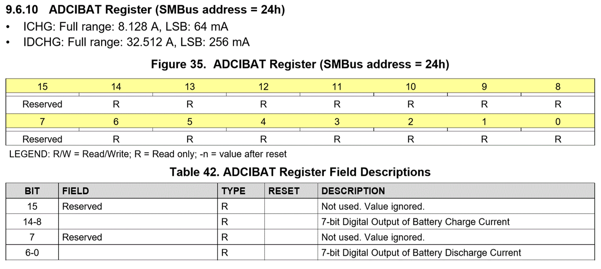

BQ25710: is the ADCIBAT() actual charge/discharge current?
Part Number: BQ25710
Customer is asking whether the actual charge/discharge current can be obtained from the ADCIBAT() resigter. Could you please help confirm it? Thank you.
