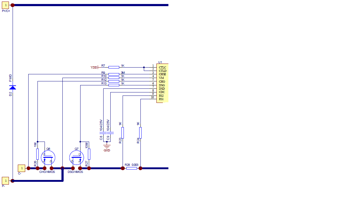

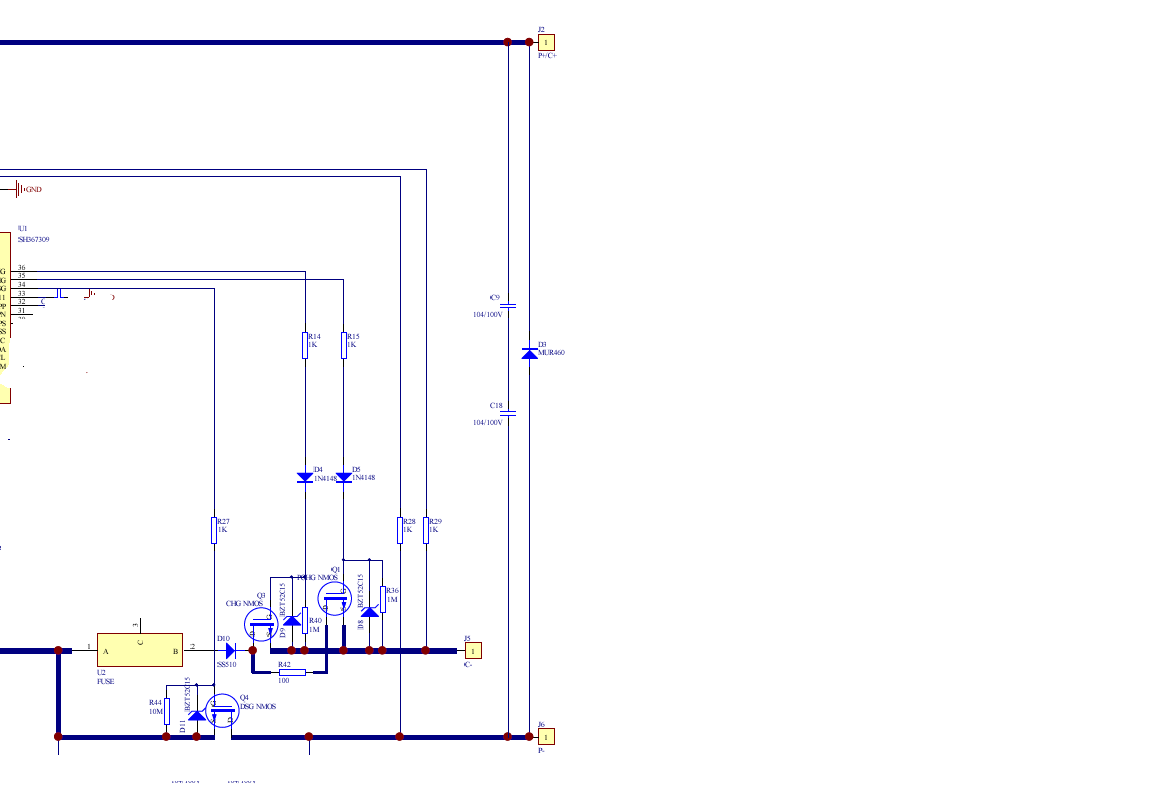

BQ40Z80: Could BQ40Z80 support the topology with separated charging and discharging terminals?
Part Number: BQ40Z80
as the typical application schematics in BQ40Z80, there is only topology showed which has only 1 terminal, the discharging current will have to go through the charging MOS. the customers are wondering if BQ40Z80 can support to separate charging and discharging terminals? so the discharging current may not necessary  to go through the charging MOS.
thanks!
