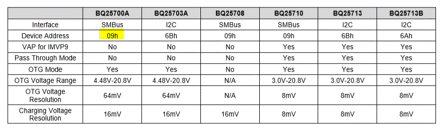

Dears,
Please help check BQ25700A I2C ADDRESS for me , I used 0x6aH is wrong , log as below. Please reply asap, thank you.
[    7.680426] <1>.(0)[1:swapper/0][name:bq24296&][bq24296_driver_probe]
[    7.681183] <1>.(0)[1:swapper/0]i2c i2c-3: addr: 6a, transfer ACK error
[    7.681204] <1>.(0)[1:swapper/0][name:i2c_mtk&]i2c_dump_info ++++++++++++++++++++++++++++++++++++++++++
[    7.681213] <1>.(0)[1:swapper/0][name:i2c_mtk&]I2C structure:
[    7.681213] <1>[I2C]Clk=12480
