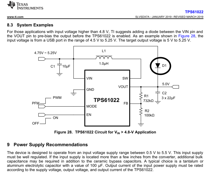

Hi Team,
my customer using TPS61022 for solution , and having a question as below
if they using TPS61022 to convert 5V to 5V for system. What's the rating of D1 ? do you have an recommend part as reference?
The application Vin is 4.75~5.25, design output target is 5V/2.2A (Max)
please kindly help to give the suggestion , thanks a lot!
