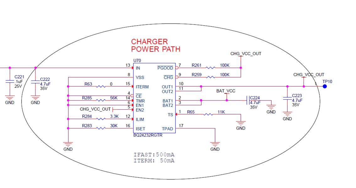

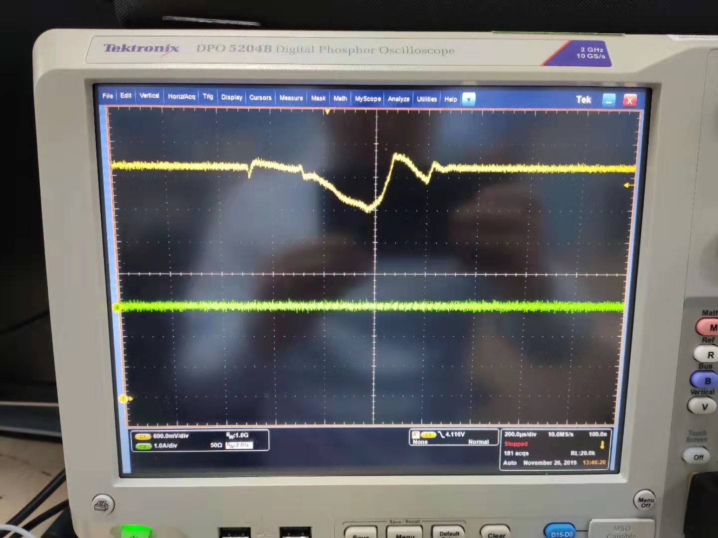

Hi Sir,
Schematic is as below, when the load of CHG_VCC_OUT is change, the volatge will change as below, around 600mV, how to improve it? Should I need a bigger cap?
Thank you.
Penn

Hi Penn,
How much of a load change are you seeing? Are the waveforms for voltage and current at the output? Recommendation at this point is to increase the cap value and see if that helps.
Hi Pham,
It looks the load rise so quick, I will increase the cap value and soft start the load to make it better.
Thank you.
