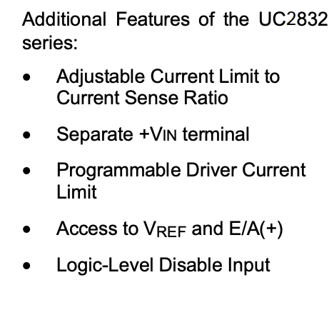

  • Hi Shlomi,
    There is no difference in the temperature range for these two devices. The biggest difference is that the UC2832 has more features than the UC1832:
    I hope this answers your question.
