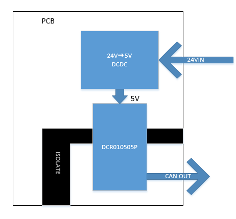

  • Sorry for so late,here is the result and the block diagram of my board shows as below.
    non-functioning unit:
    1. -VS (-probe) to Sync (+probe) = 28.8Ω
    2. +VS (-probe) to Sync (+probe) = 7.1MΩ
    3. -VS (-probe) to +VS (+probe) = ∞Ω
    4. -VS (+probe) to Sync (-probe) = 28.8Ω
    5. +VS (+probe) to Sync (-probe) = ∞Ω
    6. -VS (+probe) to +VS (-probe) = 7.2MΩ

    block diagram:
  • Sorry for so late,here is the result and the block diagram of my PCB:
    6. -VS (+probe) to +VS (-probe) = 7.3MΩ

    Block diagram:
    Thanks.
    Was there a pattern across your non-function units? The impedance on your non-function unit of SYNC to GND is lower than expected. Agains, safest conclusion would be that the parts experienced an EOS.
    Alejandro
