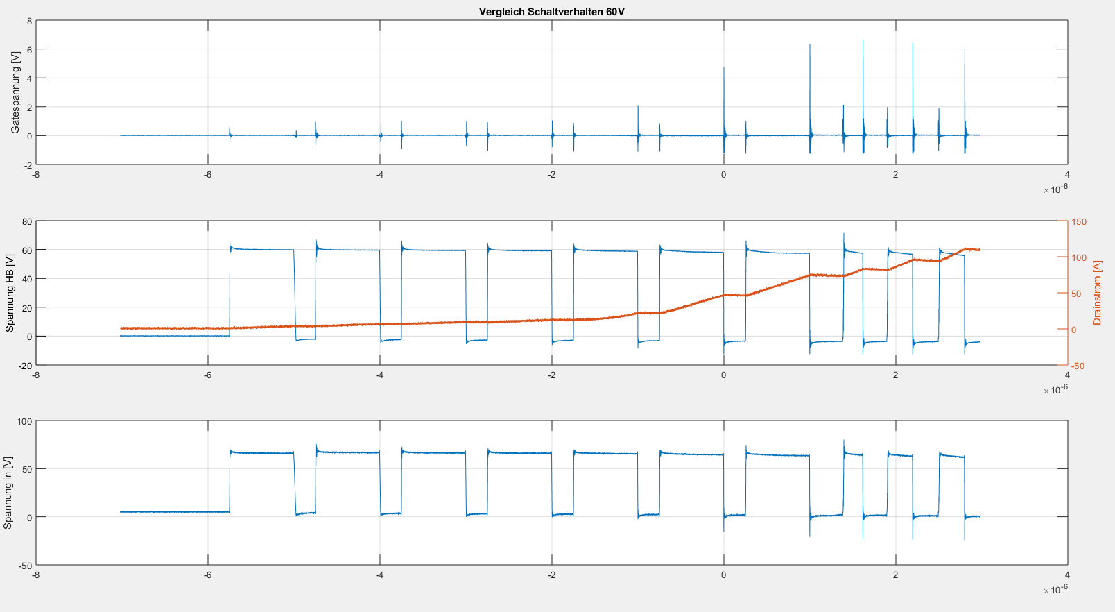

    I attached three figures with three plot each:
    --> first plot: gatevoltage of the lowside (LO-voltage)
    --> second plot: switching node and output current
    --> third plot: gatevoltage of the highside (HO-voltage)

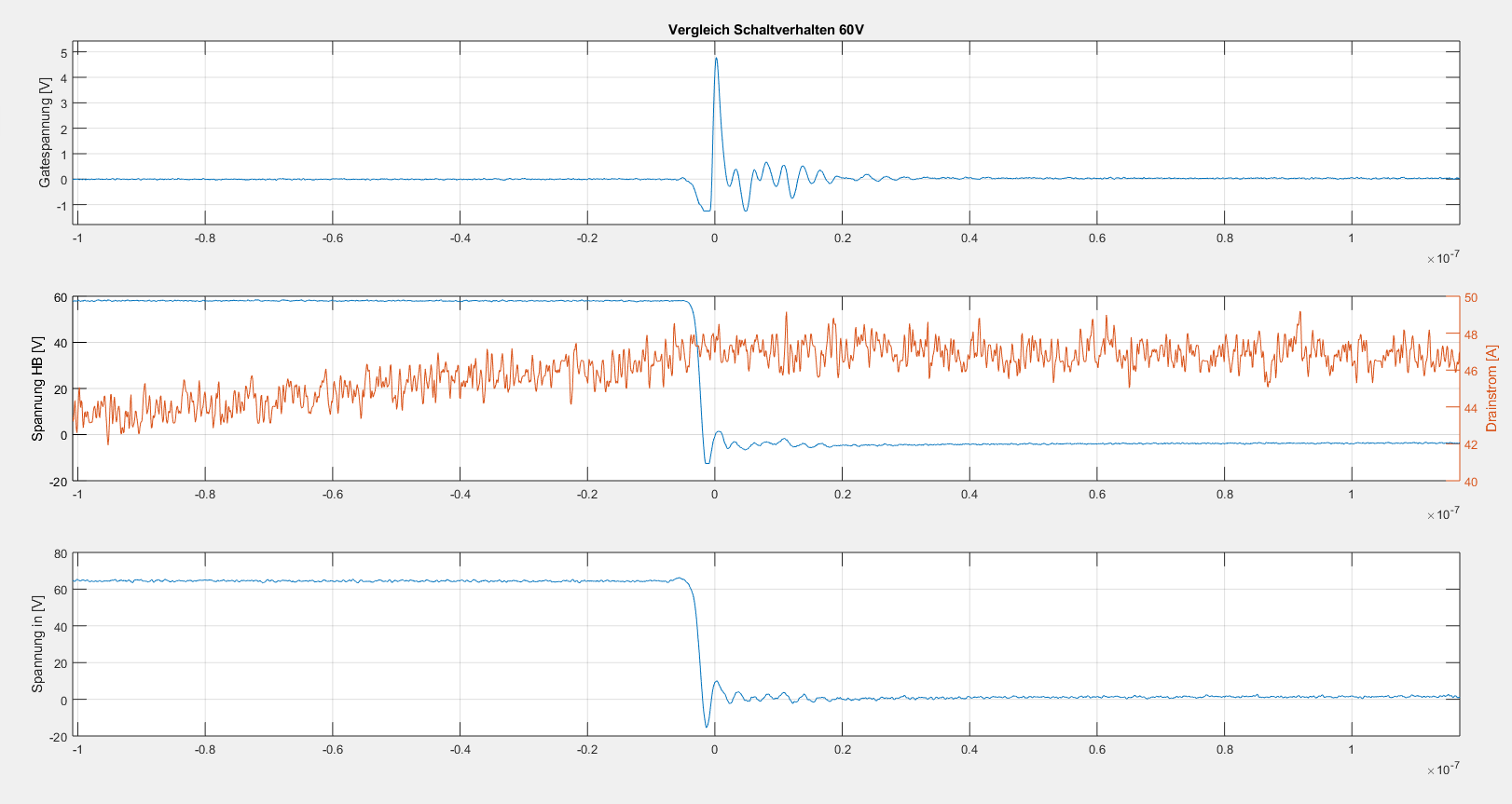

    Figure 1: overall plot of the doublepulse test (sitching the highside with inductor parallel to the lowside)

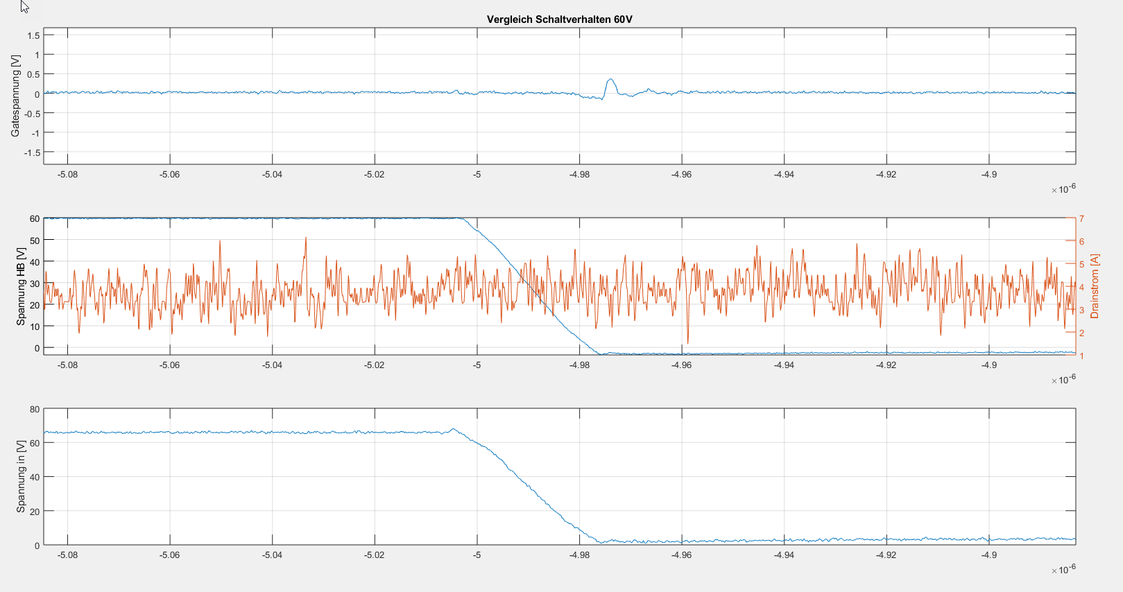

    Figure 2: zoom at t=-5µs, where the ringing is very small (swtiching about 4A)
    Figure 3: zoom at t=0µs where the ringing is high and leads to parasitic turnon (switching about 45A)

    Can you tell me the maximum dv/dt  for figure 3?

    maximum dv/dt of figure 3 is about 50kV/µs and the dead time is about 30ns -> normally we do have light load conditions so the dead time was chosen quite high.

    Thanks for the update, lmg1205 has a cmti rating of 50V/ns max. That means if the part sees a slew rate on HS this high it can corrupt the input signal or negatively impact the driver output. To lower the dv/dt on HS try using a 2-10ohm gate resistor to slow the switching transition down and test under the same conditions. If the max cmti can stay under 50v/ns its possible this issue can be fixed.
