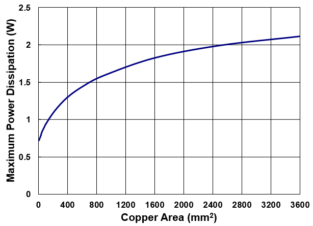

    Customer would like to estimate the PCB cooling area for the uA78M05 SOT-223 package. Could you offer the thermal resistance Information or simulation results of uA78M05? With this, customer can try to estimate the pcb area on the critical design. (The board has been in the mass-production, customer don't prefer to modify the PCB greatly)
    For example: Relationship between the copper area and the thermal resistance θJA and power dissipation.
    below diagrams are obtained from other supplier.

    We do not have this for the UA78 but we are bringing a thermal widget online that will do the same. Let me see if I can prioritize the UA78.
  • Do TI have imformation about thermal resistance vs copper area for SOT223 package?
    Can we try to use the thermal widget online by ourself?
    Thank!
  • Hi Brian,
    the TJA parameter is the best for predicting the potential thermal rise in the application.
    If you want to use a thermal widget to compare with another SOT-223 package, that will give you an idea but the two key parameters for determining thermal performance are the package and the area of the die. I am pushing the packaging team to get the UA78 thermal widget done ASAP so you can get more precise estimates.

    The thermal data comes from the packaging team. I have been pushing to add the UA78 to the thermal widget. An example of which can be found here:
    https://www.ti.com/product/TLV1117?utm_source=google&utm_medium=cpc&utm_campaign=app-null-null-GPN_EN-cpc-pf-google-wwe&utm_content=TLV1117&ds_k=TLV1117&DCM=yes&gclid=Cj0KCQiAjfvwBRCkARIsAIqSWlN9MG7w01hcE1a2XkedQa1iXIQF78YCN6P9Ow_tZZcL-Rc1UancZXwaAqsiEALw_wcB&gclsrc=aw.ds
    The above link is for the TLV117 ion the SON package but can give you an idea as to how copper weight and area can help with thermal performance. If I can get the UA78 added to this tool it would be much more accurate.
  • Hi Brian,
    I have been pushing to get this done. We ran into a hurdle in that the thermal widget was not designed for constant drop-out devices (i.e. drop-out does not change much as a function of load current). So this may take some more time to bring online. Meaning if we implement as is, the user could enter in VIN=9V and VOUT=8.0V and the tool would give a plot similar to what you show above. This is not possible.
    For the short term, the explanation above to use TJA to predict thermal rise is the best approach and then increasing the copper area only helps to improve that metric.
    Once we optimize the thermal widget, I have a plan in place to add all of our popular devices.
