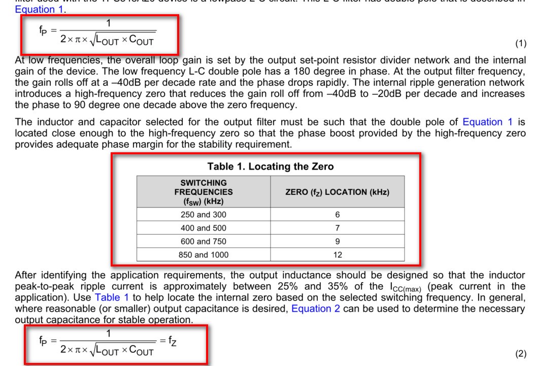

    Could you pls help to address the LC setting for the stability requirement on Datasheet.
    on datasheet page 17, fp double pole should be close to fz like Table 1 shows.
    1. What's the derating factor for all MLCC part? Why the Table 2 Recommended component value have a Cout range from min to max?
    2. What's means of the INTERNAL RC SETTING?
    If i have the 12Vin 3.3Vout, 8A,
    1.5uH Lout, what's the recommended Cout for this design? Which setting of LC can meet the stability requirement?
    table shows 3x100uF as the maxim, it that means I can't stuff more capacitance than 300uF if use all MLCC part?
    What about if i use PolmerCap mix with MLCC? tHANKS.
    regards,
    YC
  • YC,
    I think those questions are all answered in the paragraph text.  You need to derate MLCC for voltage bias.  You can generally get the exact amount from the manufacturer datasheets.
    The internal RC generates a ramp that is injected internally at VFB to reduce jitter and aid with stability.
    The rabge of output capacitors is pretty wide.  At the low end, you can use as little as 3 X 22 uF and as high as 20 x 100 uF.  lower total capacitance uses the short time constant, while higher amounts use the long time constant.  For an 8 A design, I think something in the 200 uF range would be appropriate.  It depends on your transient requirements.
