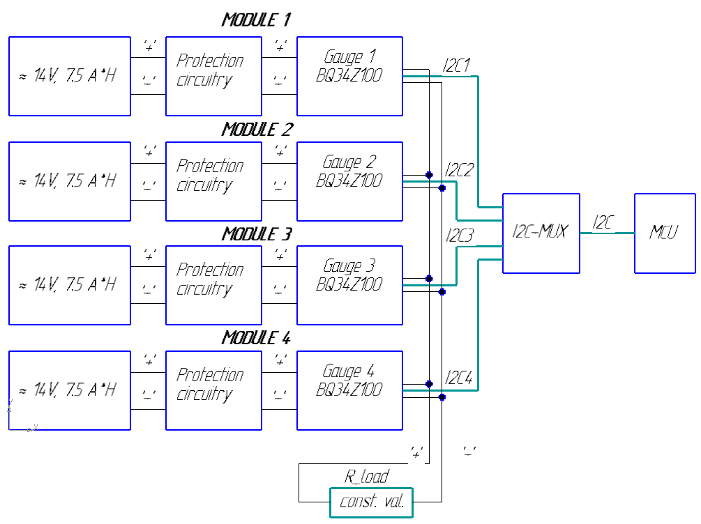

I am involved in BMS design currently.
The problem I have encountered is: the design has four LiFePO4 modules* ( approx. 14V, 7.5 A*H, 30 A*H in sum) that connected in parallel.
Each module has BQ34Z100-Z1 gauge (to obtain state-of-health (SOH) from module; number of modules in design may change from 1 to 4 items) so, MCU collects data from four gauges.
During test charge-discharge cycles I have not got valid data about remaining capacity (RC), it didn't changed.
For example, I have discharged four modules in parallel for 2 hours with current in 4 A. The RC was still the same for every gauge - approx. 7.5 A*H.
Every BQ34Z100-Z1 gauge responds to commands via I2C and provide valid data for voltage, temperature and current.
  • Am I use correct approach?
  • Can I build such a system in principle: four modules with four gauges?
  • What can I try to do to fix the problem?
*Each module contains many 26650 batteries.
Thanks for any help!
Sincerely,
Andrei.

  • Hi, Steven.
    I have added diagram of the system. It contains 4 modules, that include 4 bq34z100 (1 gauge per module).
    1: Q: How the I2C of these bq34z100 connected, are the data and clock signals simply ORed with same pull up resistor?
    A: I2C pins (SDA, SCL) are connected to I2C-MUX via pull-up resistors.
    2: Q: How does the host MCU identify each battery pack?
    A: Host MCU switches between every battery via I2C-MUX. So, MCU communicates with bq34z100 in series. No address conflict.
    This approach was tested with another gauge and all was fine.
    3: Q: Is there any circuit to manage the load allocation for the 4 battery packs connected in parallel?
    A: As load I use resistor with constant value (couple of Ohms).
    4: Q: Is there any protection circuit for each module?
    A: Protection circuit helps against overcurrent, over- and udervoltage cases. When such event takes place, output from battery is cutted off.
    Q: How the circuit manage the FETs if other packs outputs are higher than its self?
    A: Unfortunately, I don't now much about protection circuitry. Before adding bq34z100 to module all batteries were connected
    to equalize them in voltage.
    Then was made couple of charge-discharge cycles.
